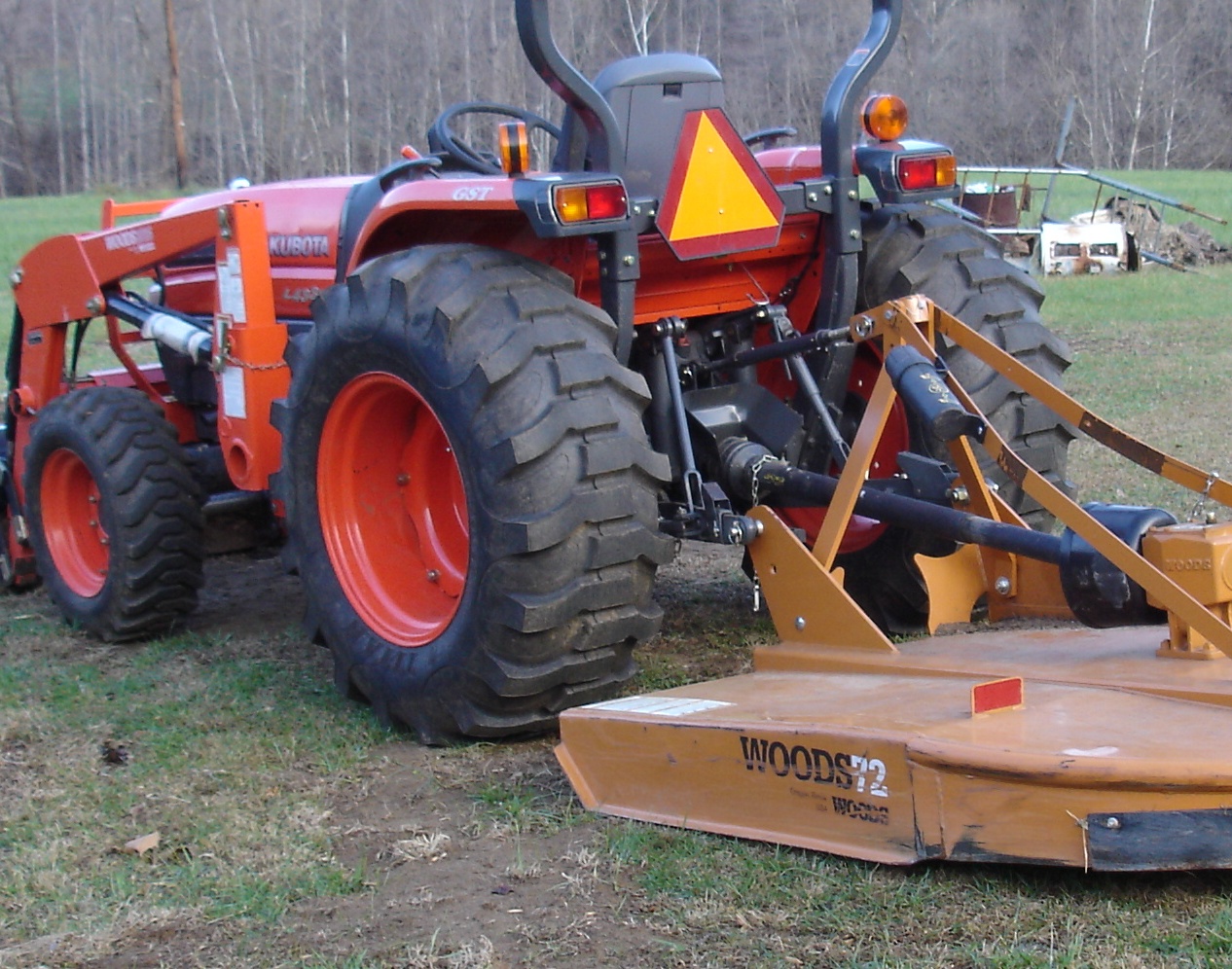

Anyone have any pictures of the back of their Kubota L series tractor with the wheels wide spaced?
   / Rear Wheel Spacing #7
Thanks for the pic TripleR. Are these Wheels wide spaced? They look close to the inside frame. I'm trying to see if mine are wide spaced, but they look about the same as yours. If they are spaced, how much additonal width did you get?
   / Rear Wheel Spacing #9
I had mine spaced out as far as they would go by the local dealer.
Before:
After:
I can really see it on yours FTH-05. I'm using the outside edge of the tail lights as a guide, and the center of your tires are further out by maybe 5". Mine, although I don't have a good pic of it right now looks about centered with the outside edge of the light. That's good news for me.
