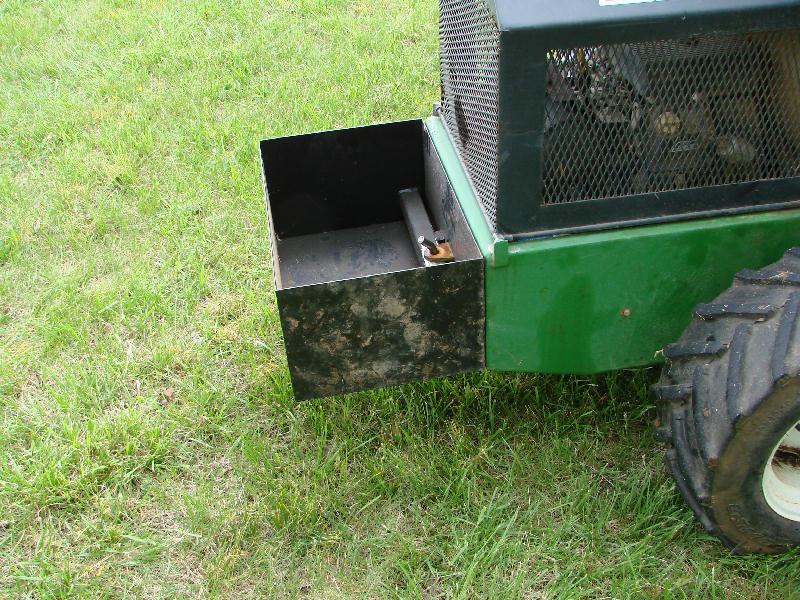

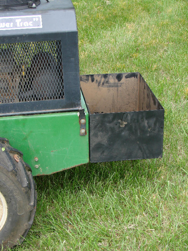

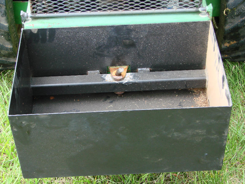

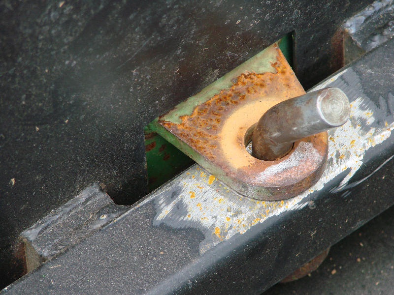

Since the hydraulics on my PT-425 are stronger than the weight of the machine (lifting the rear of the tractor), I had a friend fab me up a rear weight box that doubles as a toolbox, chain box, etc. Because it pins tight against the rear of the PT, it will readily handle 175-200 pounds of weight. Though I haven't used it a lot because of working in the trees, I've found it quite useful when doing loader work...

Yep! Since I have my wheels reversed (and loaded tires), I plan to use it only when I need the extra weight or need to haul things like my chainsaw, chains, etc.

I like the idea of a chain box. But I pull with the rear hitch. Any thoughts as to extending a brace inside to allow for a hitch on the rear of the box?
   / Rear weight box/tool box for PT-425

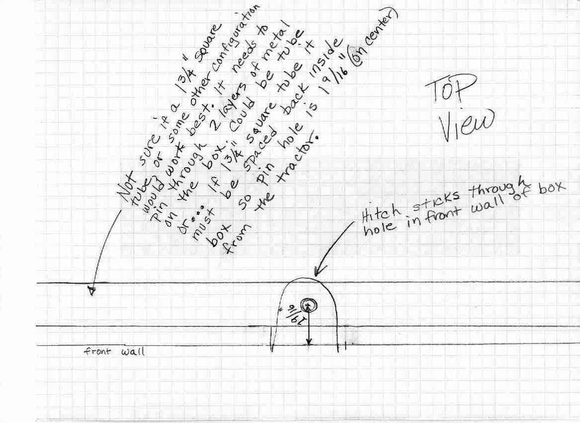

I thought about it a bit, but thought I'd need that "extension" to actually pin on the hitch also, to transfer the stress directly to the PT and not the weight box. For example, you could put a "T" in that internal brace that extended out the rear of the box, with ears that would also pin in...
bottom line is that I didn't come up with an easily fabricated solution that wouldn't block most of the center section of the box, so I took the simple way out...

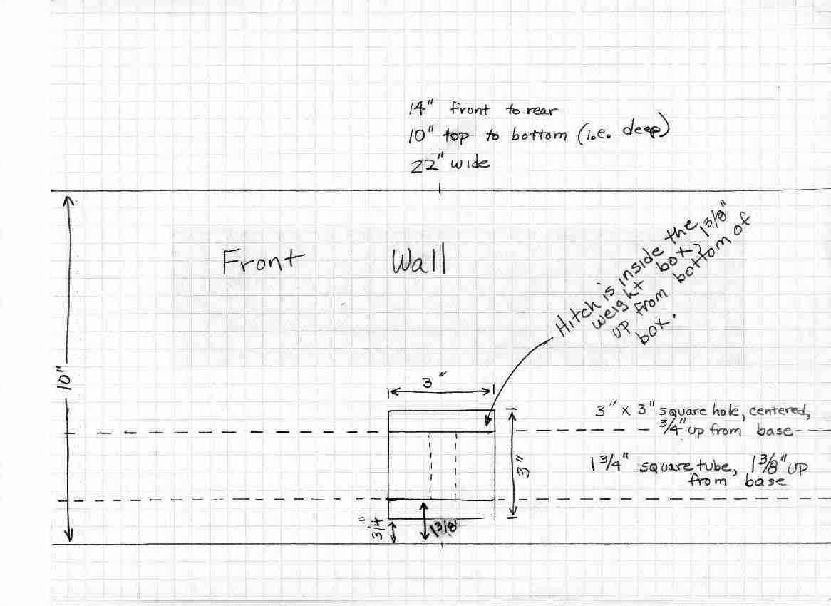

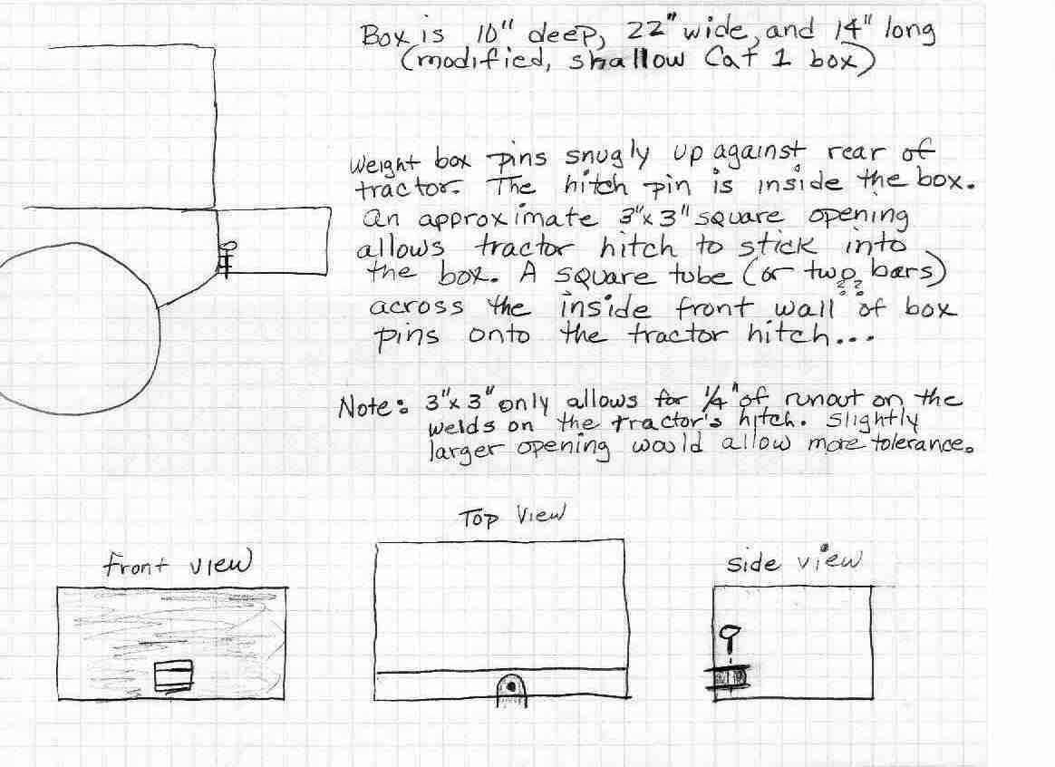

I found these on my PC -- they might be of value -- they're what I gave my friend to work with. You may want to confirm the measurements, though, since I had to do a bit of "clearancing" to get the bar to fit in the PT hitch...
