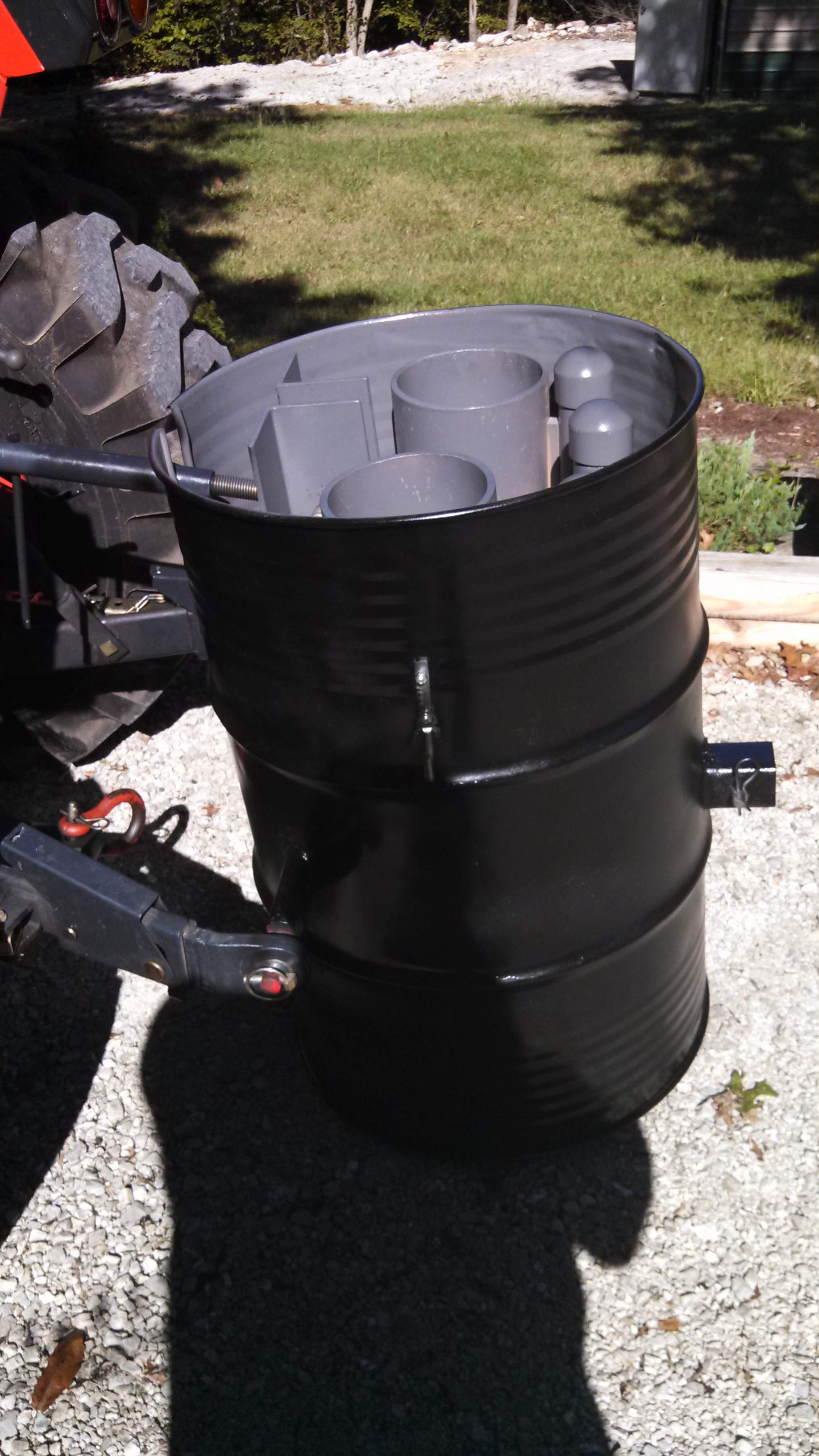

There are a lot of posts on home-made ballast boxes....most are cutdown 55 gallons drums fill with concrete.
80 lbs probably isn't enough...depending on your tractor's and loader's capability, you'll probably want 400 lbs or more.
As an example, my loader is good for 1200 lbs full height lift and my ballast box weighs in the neighborhood of 600-700 lbs.

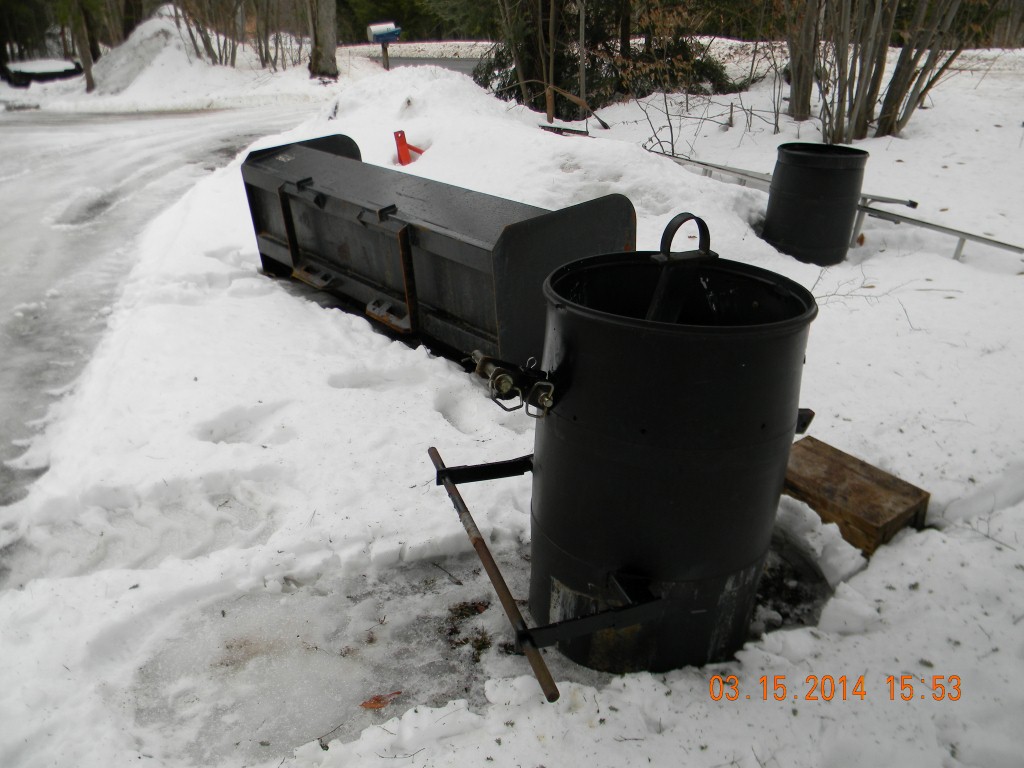

Green Tea,
I made a rear ballast for my tractor using a plastic 55 gallon drum. Cut and installed a piece of rectangle tubing on the bottom and welded some 1/4" plate out to a 1" solid round bar. Welded in supporting framework for the top link and added a top lifting hoop to move it around. Then filled it 3/4 full of redi-mix. I estimate weight between 850-950 lb. You could make something similar using a 33 gallon barrel filled 1/2 to 3/4 with extra cement / concrete you may have.. For your 700 loader capacity you probably only need 350-450 lb rear ballast.
   / rear weight ballast #8
You can buy what is called a Drawbar at Tractor supply to get your project started click here. You could use a smaller barrel than my 55 gallon one or a trash can for a form or make forms with wood. (be sure to coat your wood on the inside with used motor oil for easy release) you may want to include some pipes for handle tools, I find that very useful, or a chain saw scabbard, or anything else you mind can think up. There are lots of thread on here with guys that have build ballast boxes out of lots of stuff.
