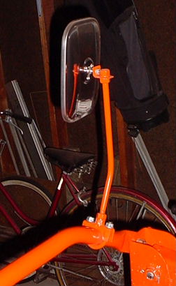

When I use my tractor (L 2800) Kuboto, I have to have it on a public road for from one hundred yards up to three miles. I would like to have a Rear view mirror so the traffic wouldn't sneak up on me from behind and I could keep a better eye on my dog who follows me when I go. I tried one of those stick on mirrors on the rear vertical part of my fel. It really didn't work very well and has now come off due to all the trees and brush I go through making trails on my property. I'm thinking along the lines of a fold down or even better an easily removeable mirror maybe mounted on the right fender in the existing holes for a handle like on the left side, or I guess I could move the handle and mount mirror on the left side. Anyway if anyone has any ideas on this I would love to hear them. Thanks.

I too have to travel on public roads and my neck gets a bit twisted watching for traffic after a few blocks. I used a muffler clamp and a bit of rod stock to make this bracket. Attached it to the cross brace on the FEL. Vibrates a bit.......but I can see pretty well behind me now.
Good Luck!
