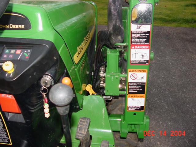

I have a JD4520 with a 400X FEL that I would like to mount a rear view mirror (maybe 2). Anyone have an idea how it could be done---and the type of mirror?
   / Rear View Mirror #2
Not sure if this is what you want but...
I mounted 2 spot mirrors on my loader uprights(one on each side). The cost about $2.00 each at WallyWorld. It is not the best, but they are helpful.
The other choice is to get a canopy and mount on up there, but that'l cost $400-$500 smackers...
See attached pic...

If you go to "Paynes Forks" online I think you will find a pretty well designed "clamp-on" mirror. It is designed to clamp, via rubber coated spring bar to the loader arm/arms.

Well, for less than $5.00 its worth a try! It does help me, as far as a 84" attachment, you will have to find out on your own, I have nothing that big. I did run a 5' seeder, probably 66" overall width and could see it.

I bought 8" stainless steel convex mirrors at the local truck supply / parts store. Bolted the mirrors to the 10mm holes supplied on the back side of my 410 loader uprights. If no supplied holes, a 5/16" drill bit can produce the very same results!
The mirrors came with a 3" extension arm which could be used to raise the mirors (lifting or projecting the mirror, say, outward. The 8" convex work great for my failing sight and sore neck!!
