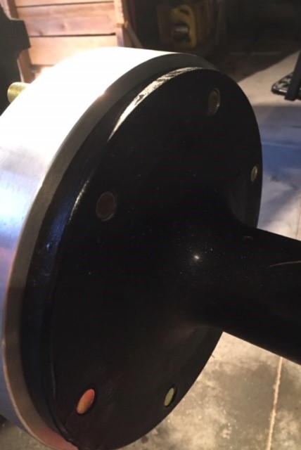

I bought wheel spacers (1.5 inches) so i can have the chains on without hitting the sides of the fenders, etc. i was looking in the manual and it states 262-282 ft. lbs. seems high to me. does that sound about right? do other tractors have it this high for a 55hp tractor? or maybe its a misprint in manual. i wouldnt think so but thought i would ask before stripping them.

Did you get your answer from the dealer? The torque charts I found go by bolt grade and bolt diameter. I have a 2655 which is essentially the same tractor and if I remember correctly the rear wheel bolts are 16mm grade 10.8 which puts the torque spec at 230-280 ft lbs. That said, when I was installing my 2" spacers I only tightened them to 150 ft lbs since my spacers are aluminum. I didn't want to risk pulling the studs through tightening the wheel on.
I also used red Loctite on the bolts that hold the spacers to the hub and since you can't get to them without taking the wheel off. I also used a white paint pen to put witness marks on the end of the bolt at the inside of the hub so I can see if they've moved. I took this pic before I made the marks but basically just a mark from the center of each bolt out and onto the black portion of the tractor hub. If the mark ever gets out of alignment then I know I need to pull the tire and retorque the bolts.

And my biggest gripe with the Mahindra manuals including the service manuals is that they don't give the torque specs for specific bolts on the tractor, only general specs. When I had previously discussed this with a service manager at one dealership he said the torque charts are one thing but you also have to consider what the bolt is threading into since going to the high torque specs can also damage the threads in some of the castings. It's kind of a crap chute...I just try to make sure everything stays tight and I stay at the low end of the torque specs or even lower than the specified number if it's not a critical component. In reality you just want everything to be tight and not be able to move. Doesn't necessarily mean you need to stretch the bolts to get it tight enough.

Yeah, the dealer didnt have a spec chart for the tractor but he checked with one of the mechanics in the shop and said 140-150 ft lbs is what they usually do. i got mine from motorsport tech. thanks for the info. i do use witness marks on the lugs when on the rim but i never thought about putting them on the back of it like you did, thanks that will put my mind at ease to know if the spacer bolts are loosening. i hope these spacers fit, it will be a pain to ship back.

After torqueing down all lug bolts then took one out at a time to put blue loctite and lock washer on. torqued to 150ft lbs. on all bolts
Put witness marks on all wheel spacer to axle bolts (on back of axle since you could no longer see the head of the bolt holding the spacer in) and rim to wheel spacer bolts.
