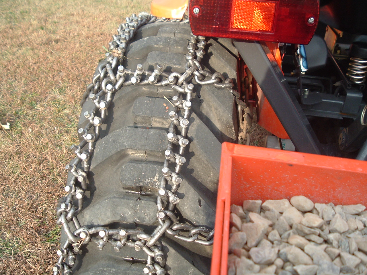

I run the two link 3/8 ladder chains from tirechains.com on my CK30hst Industrial tires with no problems. Just make you put them on snug and use good chain tensioners.

Mine are R4, Industrial tires, 15 - 19.5. My CK30hst is a 2004 manufacture year. Unless Kioti made a big change in the fenders, you should be fine. My chains never hit the fenders. I just install them snug on the tires and use the chain tensioners that Tirechains sell to keep them tight. I'll get a measurement from mine. The only area that would be of any consideration, at least on mine but they don't hit, would be the outer edge of the fender. All the rest has plenty of room. I have three links from the side chain that are lose after installation and just use plastic wire ties to hold them against the tight side chain going around the tire.

We Have a 04- CK30 , Industrial tires that we used the chains from our old T30 Ferguson . They fit the Ind. tires perfect with no clearance problems . Just wish they were easyer to put on by myself .

I had a Mahindra 2615HST with the same size tires. I only had 1/2" space between the tires and the ROPS / fender support frame. I had 2" wheel spacers made for each side so at 2 1/2" I had plenty of room for 3/8" ladder chains. You should be fine at 2 1/4".

I measured mine. The closest space is from the inside of the tire to the inner part of the fender and like yours, it's 2 1/4 inch. I've never had the chains hit the inside of the fender.
