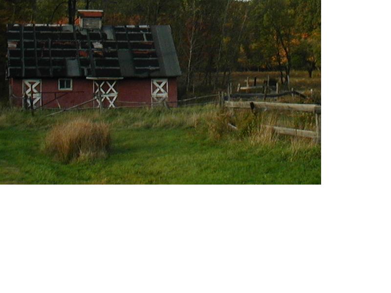

Here is a picture of the barn with a "brand new" roof /forums/images/graemlins/smile.gif.

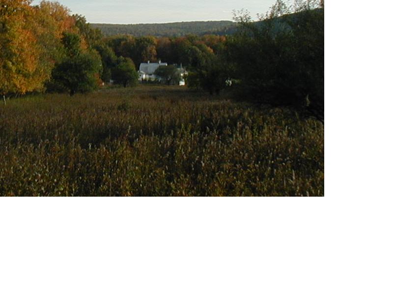

Here is another one of the ex- horse pasture.

   / Rear tire spacing #5
Unless I had to get through a narrow door or between trees too close together, or had implements that would not be wider than the rear tires, I'd go with the wider spacing for stability and ride comfort.
   / Rear tire spacing #6
I agree with Bird, not that that is unusual. That cab adds a lot of weight above the center of gravity so a wide stance would help avoid that pucker factor side slopes can offer. Will the 5' box blade be too narrow to cover your tracks with a wide setting? Might want to consider a 66" box.
MarkV
   / Rear tire spacing #7
<font color="blue"> He could set them at 5' or 5 1/2' or 6'. </font>
Start in the middle. If you only have 5 degree slopes tipping shouldn't be much of an issue. But even that can tip you if you have a load or hit a depression.
