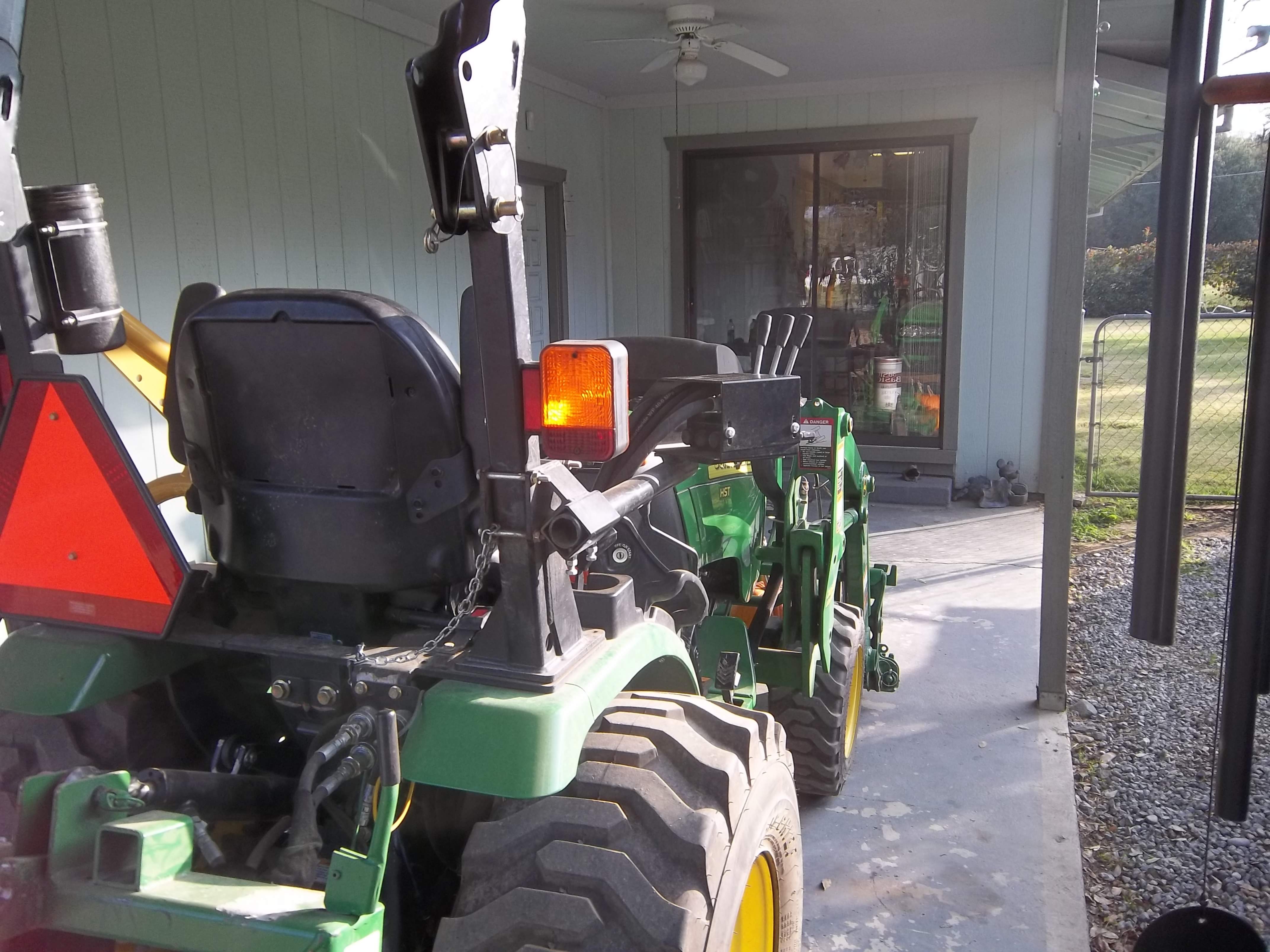

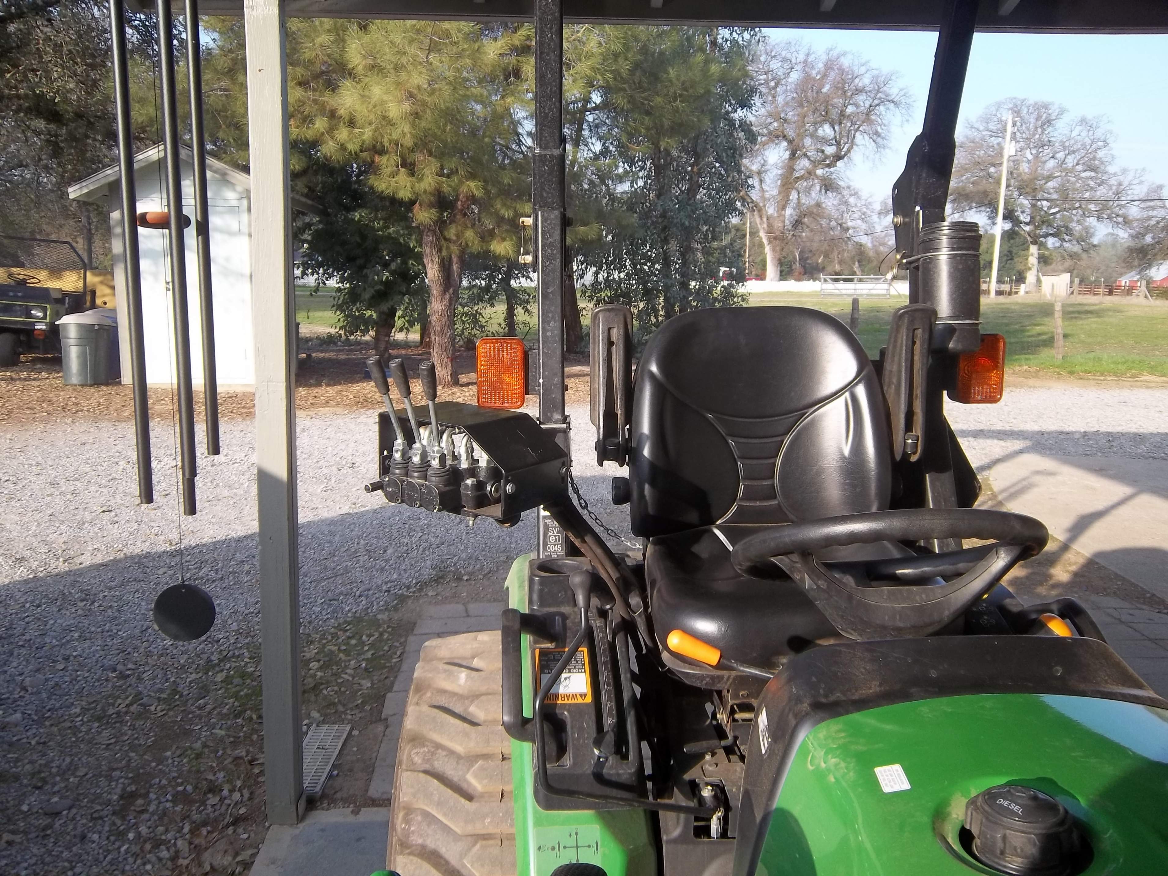

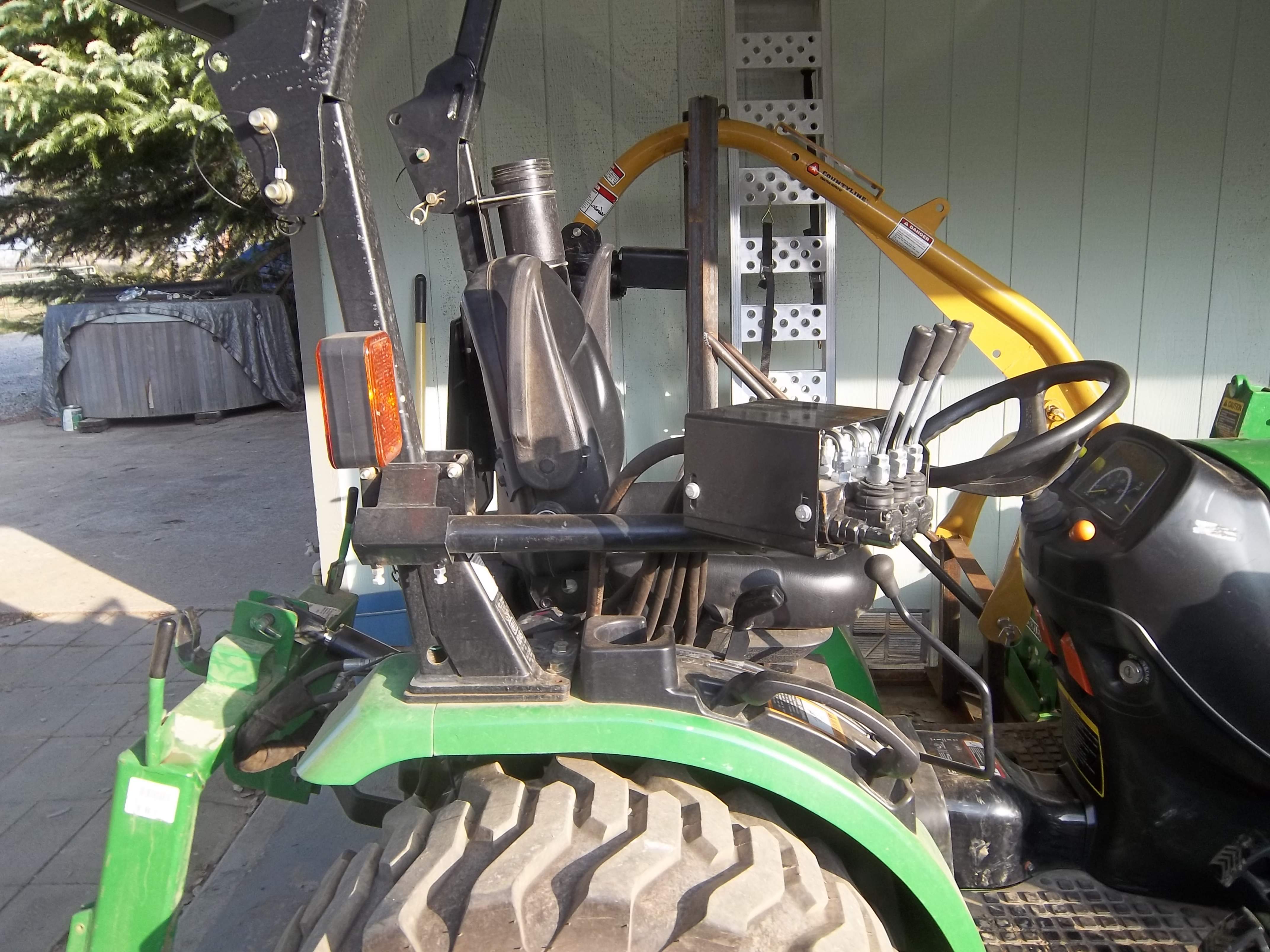

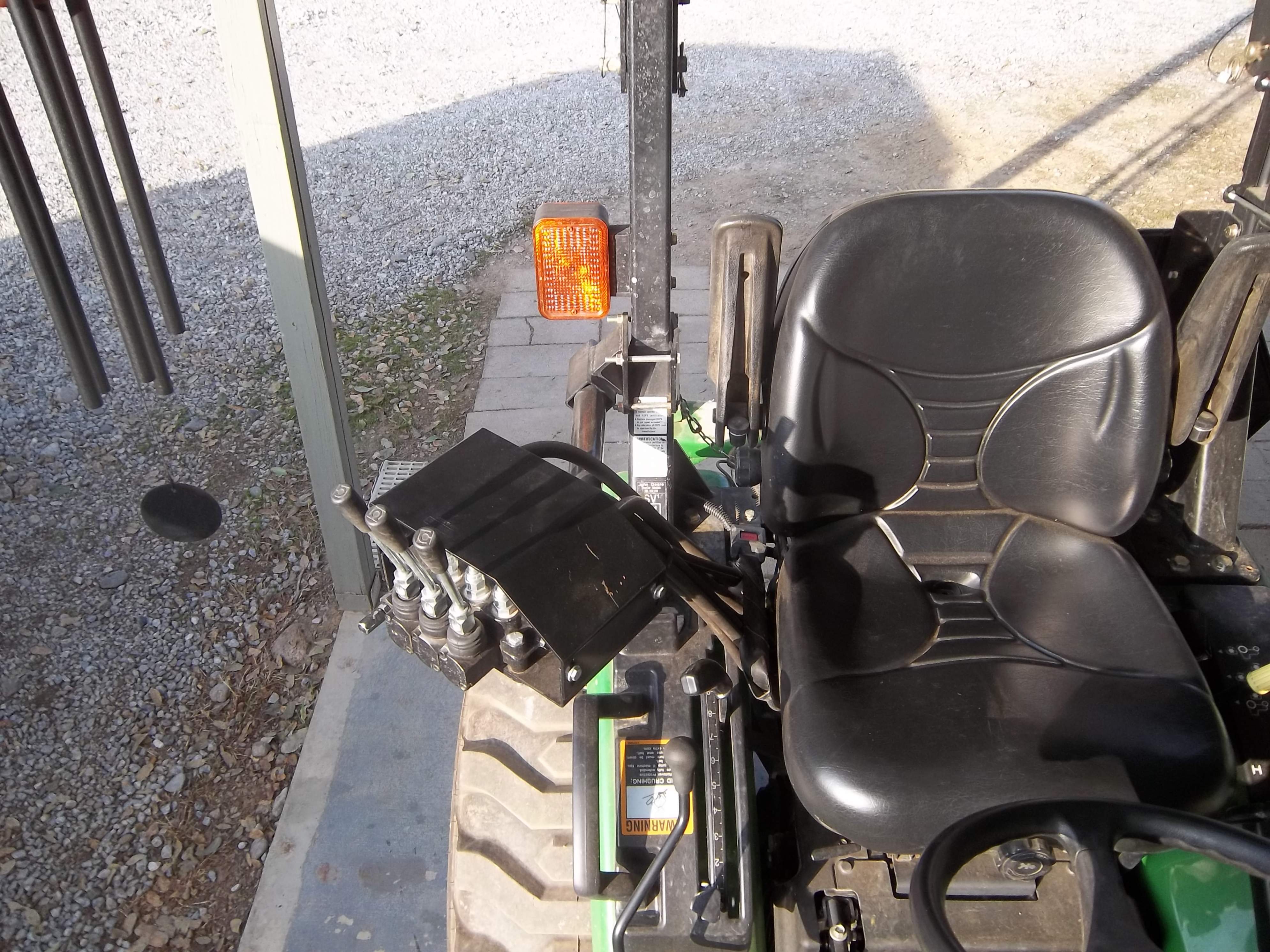

Here's some pics of my setup. When I had this installed at the dealer, they installed it on the inside of the rops and it sat straight like it come from the maufacturer. It was so bad that when I sat in the seat, it was darn near in my lap. So I took it and moved it to the outside of the rops. That was better but was not in a comfortable operating postion. I took everything loose and cut the valve mounting plate loose from the arm, turned it on an angle, then rewelded it on and reinstalled everything. Now granted it does stick out to the side a bit, which some people might not like, but it works for me. The only complaint I have on mine is that the hydraulic lines get in the way of the 3PH control when in the full up position, but I didn't want to pay for another set of lines to reroute them to a better location. Hope this helps.

Awesome. That helps lots. The valve I was looking at has the levers out the front horizontally i was thinking of mounting a little further back and running the hoses around the outside of the rops. I was considering hard piping with 3/8" stainless swedgelock tubing for a cleaner less bulky look.
