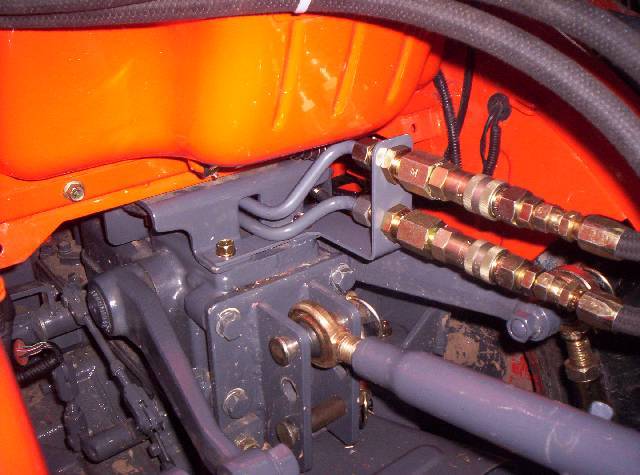

These are the rear remoteson the CK20 for anyone wanting a closer look.

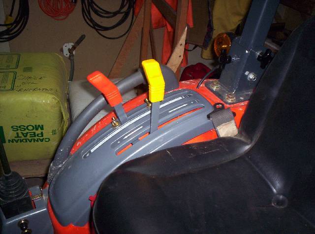

Another shot

   / Rear Remotes #3
Thanks Steve. Looks a little different than I had thought they would. Not much different really than the way I have my hoses running back from the main valve block.
I can use them for the BH or another hydro unit as well. I like the stability yours provides better though. John

   / Rear Remotes
Gerard,
I installed myself, it took about three hours to do. Had to remove seat, seat platform, tank and support bracket to get tubing out through the center part of that blue bracket. Once the tubes were installed it was pretty straight forward. Everything fit just as it was suppose to. There is a detent in both directions so that you can run the backhoe with the remotes. Got some ideas from Kiotijohn and Jon Depratt on getting the hoses the right way each time.

</font><font color="blue" class="small">( John:
Can you post some photos of your set-up? G )</font> Gerard, I think I can tell you all you need to know about it, and in this picture, you can see the hoses hanging on the toplink hook on the back of the tractor. The hoses are simply hooked into the main valve body, and run back through the cavity under the 3pt hitch lift right arm. Not the most ideal way to do it, and they are hoses, not metal tubes, but it works fine for my backhoe use, and I can still use them for other hydro implements if I have a controller. If it were hooked up the original way, most of the hoses would be on the BH, and run to some quick connects at the main valve body. This way, the hoses on the BH are shorter, and I have hydro that remains on the tractor when the BH is off. I hope this explains it well enough, if you need better pictures, I can get some in the next few days. John hydro hoses
