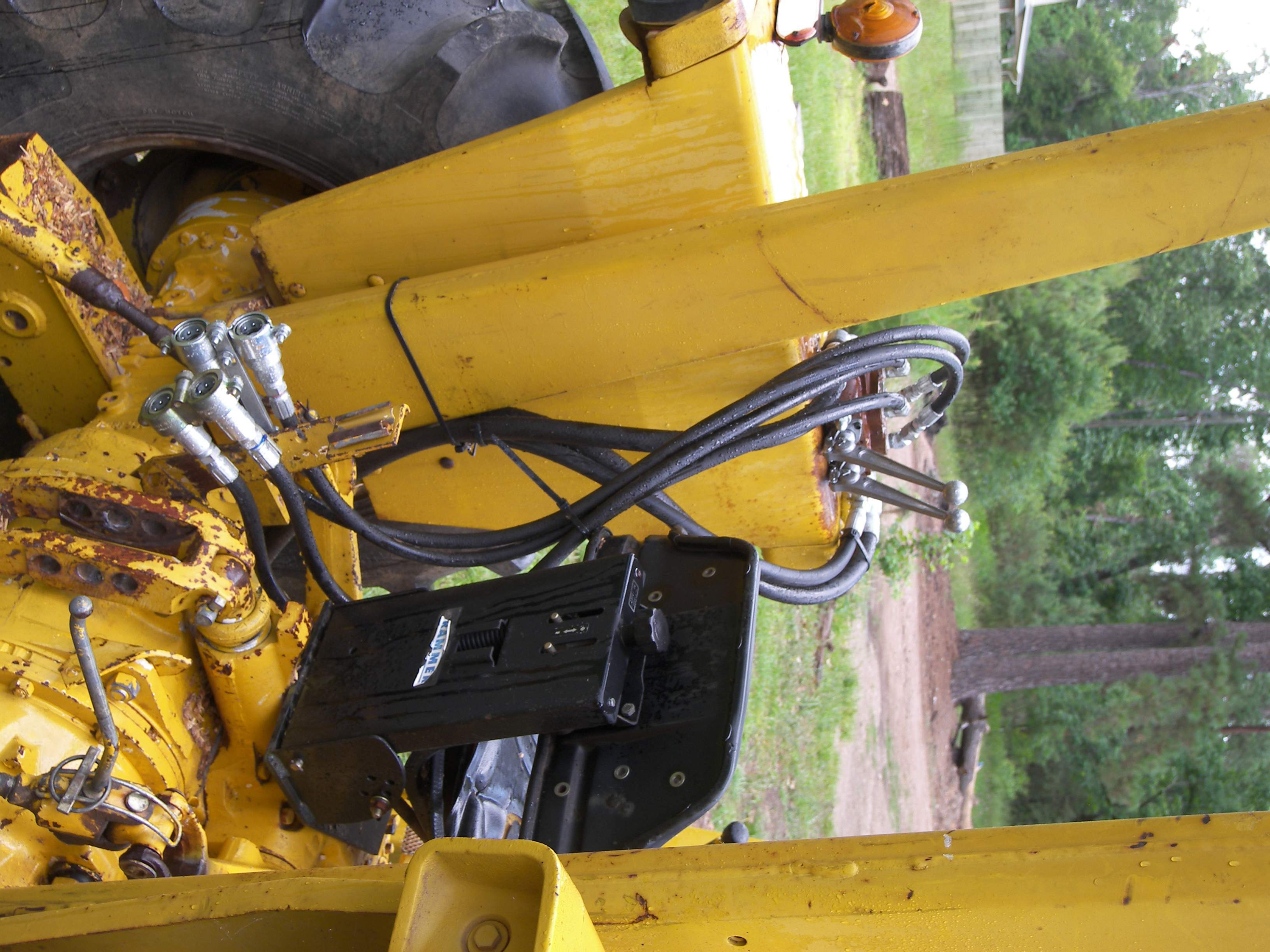

I just bought a David Brown 60 HP tractor to run a stump grinder. The tractor has 5 remote hydraulic lines the stump grinder has 4, how do I determine which to choose, can I cause damage if they are reversed? Thanks.

Yes thank you I will take a picture when the sun comes up. I have it set up on one tractor and need to move it to another tractor.
   / Rear Remotes
Here is the MF 30B that the machine was hooked to.

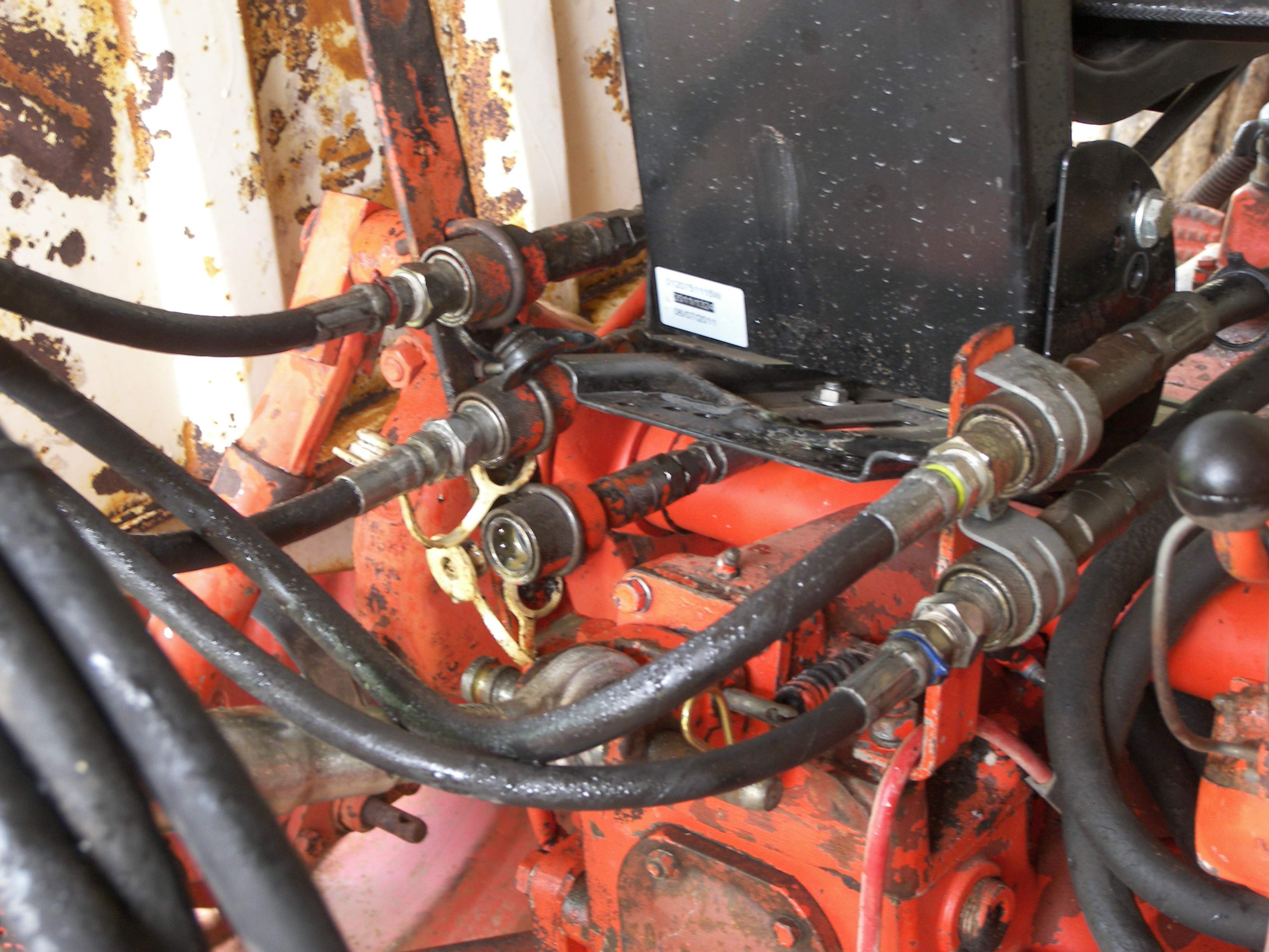

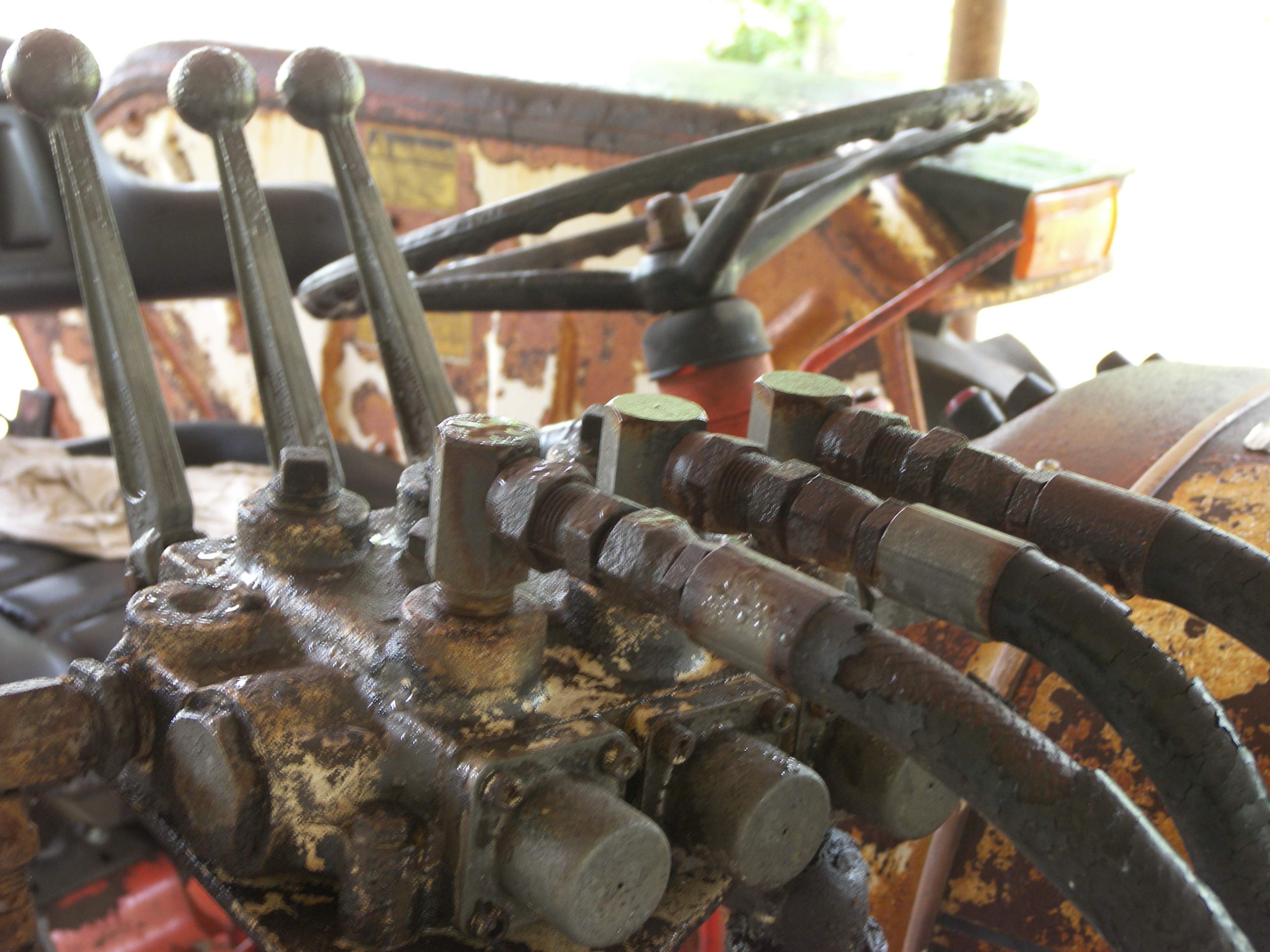

   / Rear Remotes
Here is the David Brown I am able to get about 2 inches of movement on the rams.

What is the purpose of the 4 hoses . cyl or motor.
What is the purpose of the disconnected QD in the center?
Since you are only getting about 2 in on the cyl, it sounds like a QD is not being used correctly.
Is there a SA cyl in the system?

He has already said the cyls only move about 2 in.
It sounds like the fluid from the valve has no place to go and therefore is blocking the flow.
A single QD half will block flow.

I only see 3 lines coming out of the control valve. Where are the other 2 lines coming from? I would guess you have a single acting 3 spool control valve which was used for a batwing. The MF tractor has a double acting 2 spool control valve. You might need to buy a new control valve to operate the stump grinder.

follow each hose, and figure out were it connects to on each end.
you will have, valve, hydraulic tank, tees, hose, quick connect on rear.
hydraulic tank, on older tractors may be the transmission or rear end of the tractor.
