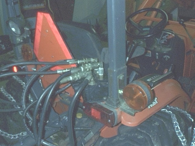

My B2710 is an early production model and has the rear flashers mounted on the fender inside of the ROPS. This photo shows how I moved the right hand flasher outside of the ROPS using a bracket from a later model B-series.

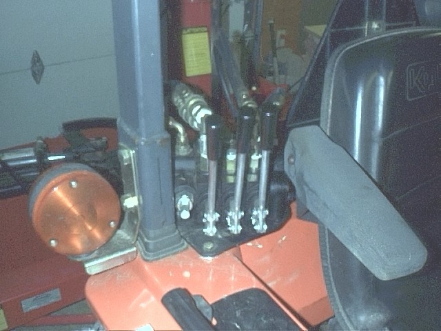

This photo shows how I mounted the valve assembly. If you look closely you will see a custom fabricated mounting plate to which the valve block is mounted. This is ten mounted to the fender using 1" spacers and a few newly drilled holes.

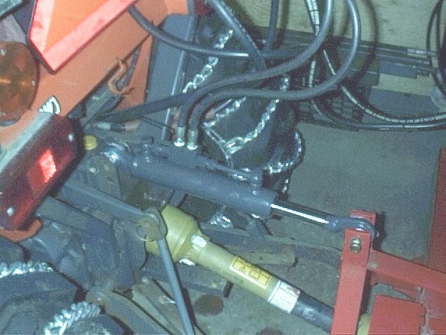

Here is a photo of the top link I purchased from CCM. I painted it ROPS gray.

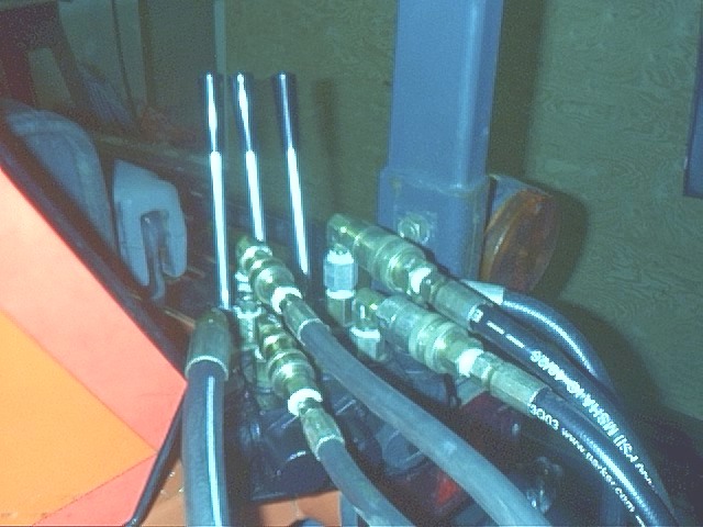

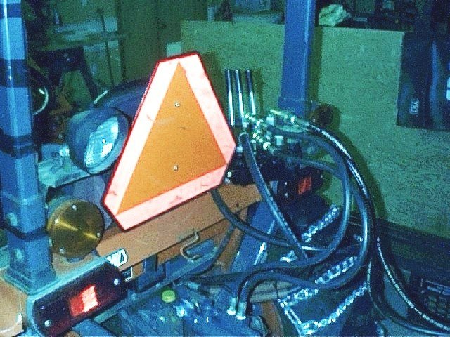

Here is a rear closeup of the valve block. Notice the hose on the left is 1/2" diameter. This is only temporary since my friends service truck did not have enough 3/8" hose left to complete the job. It will be replaced this spring at which time it will be relocated to behind the seat.
Note that I used 1/4" hose for the left spool. It is connected to the top link. The right spool uses 3/8" hose and is connected to the chute rotator of the snowblower and can be used with most any rental peice of equipment.
The center spool is currently capped off awaiting the tilt link. It will use 1/4" hoses.

Plumbing the valve block was very straight forward.
Once the Kubota aux hydraulic block was connected, the pressure side was connected to the inlet of the valve block. The other aux hydraulic block side was connected to the valve block's power beyond. The valve block's outlet or return was connected to the hydraulic reservoir along with the loader's return to tank hose by using a tee connector. This is possible since this is not a normally pressurized line.
3/8" hoses are used here but 1/4" would probably work just as well. The passage used by the aux hydraulic block cover plate looks to be only 1/4" dia. Kubota uses 3/8" hoses for the loader so that is what we went with.

One of the selection criteria on the valve block was that it not be a heavyweight monster and that it fit between the ROPS and the seat. The Prince fits that requirement by having a footprint of only about 8" x 8".

I saw an interesting valve mount at the rental shop when I picked up a roller/compacter last week. They had various size Deeres. They made a bracket which clamped around the ROPS. Then an arm extended up near the driver posistion, kinda over the front edge of the fender. The valve was mounted on the end, so the operator did not have to reach back to work the valves. And, it was easier to work when the operator would be looking over thier left shoulder on occasion.
Mine is mounted about the same place as yours...
