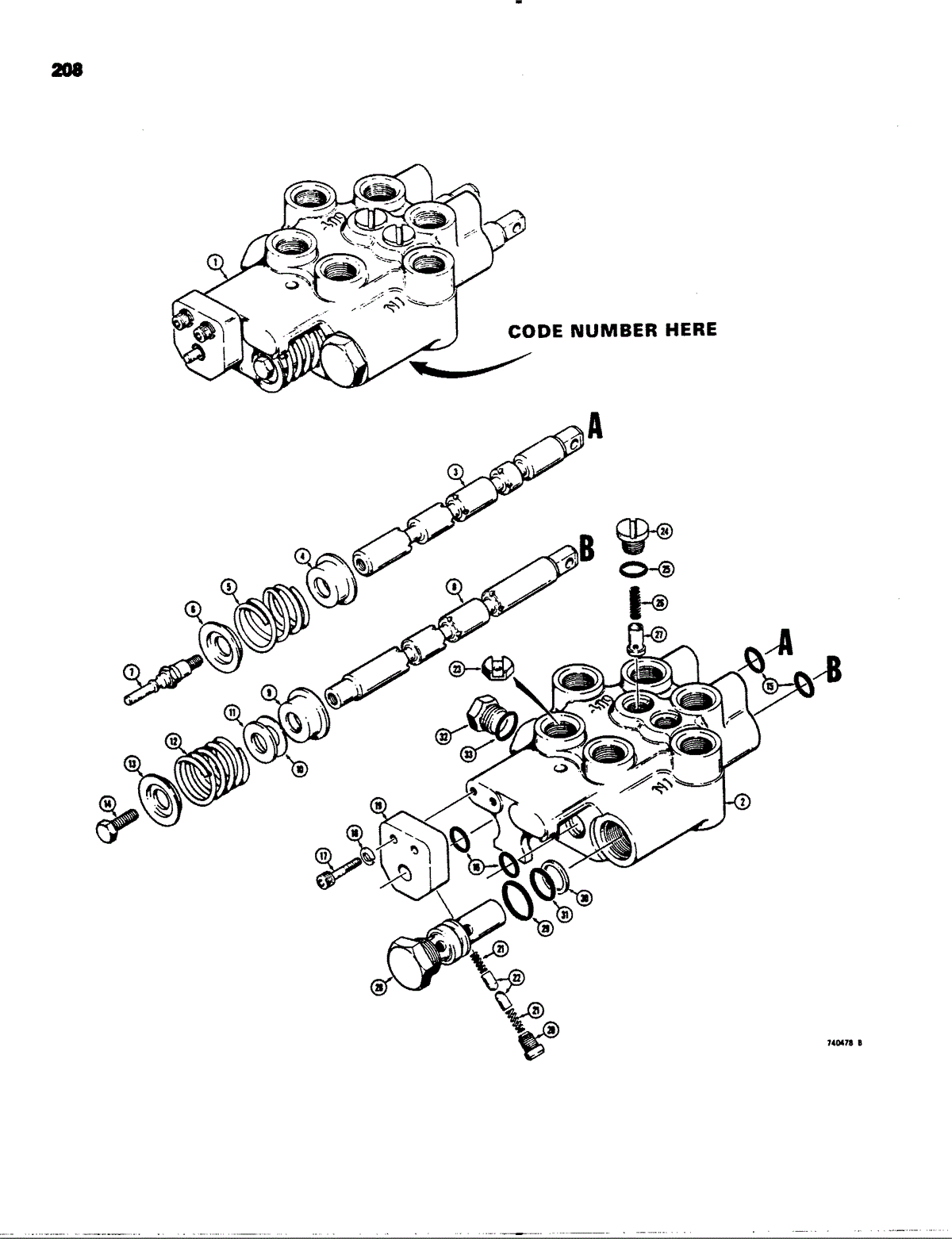

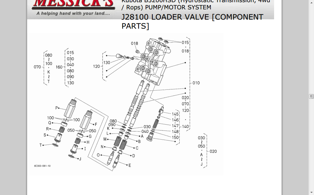

Hi all, i have dual remotes on my l4310 , both self centering?? Well one self centers, the other will not center either way. Any ideas? Im thinking springs but have no idea. Anyone have a parts diagram of these valves i could see? Thanks ray

In the normal mode, with all valve levers in neutral, no fluid should flow from the work ports. Here is an example of centering springs on a spool.
First picture is a B3200 loader valve.
Items C and M are centering springs.
Second valve is from a Case skidsteer items 5 and 12. Centering springs are a common thing in hyd valves. You will also notice the nut or screw holding the springs tight and set correctly.
