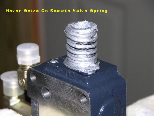

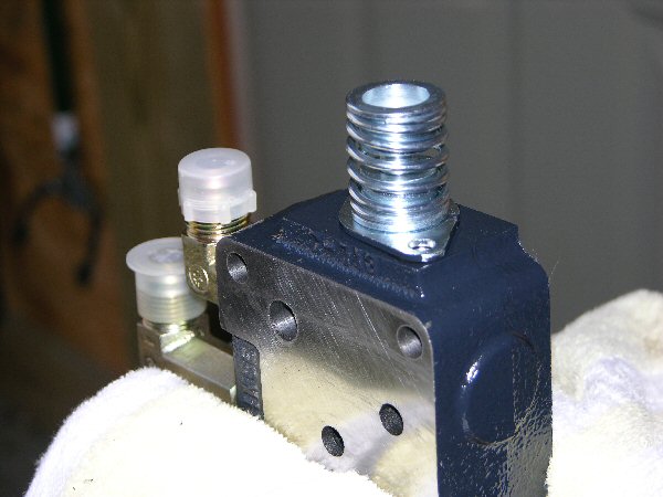

Take the cover off the remote that covers the return spring and I think you'll see lots of rust. If that's it clean it up, give it a coat of Never Seize and put it back together.
This is what the assembly looks like with the spring exposed before & after being covered with Never Seize
