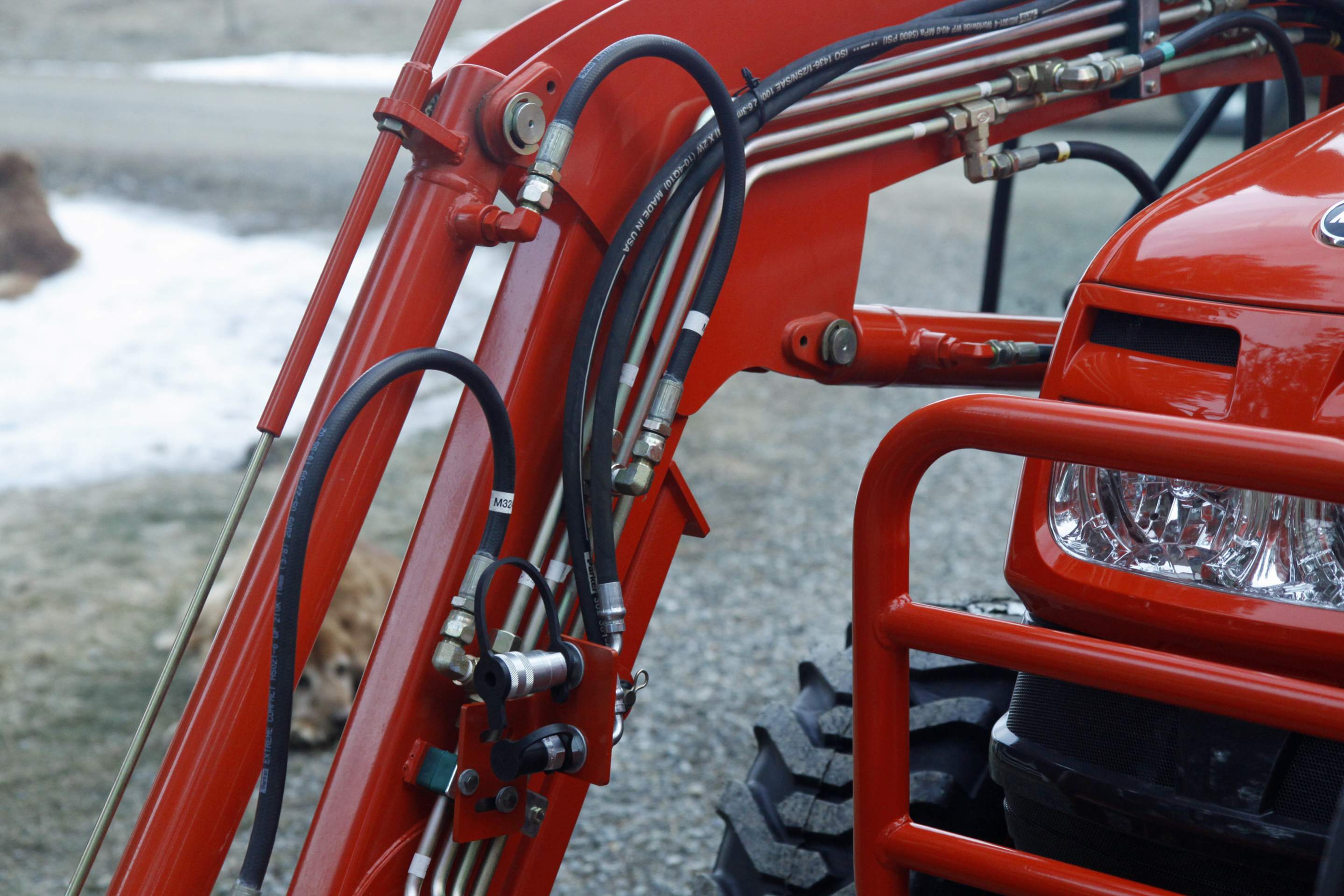

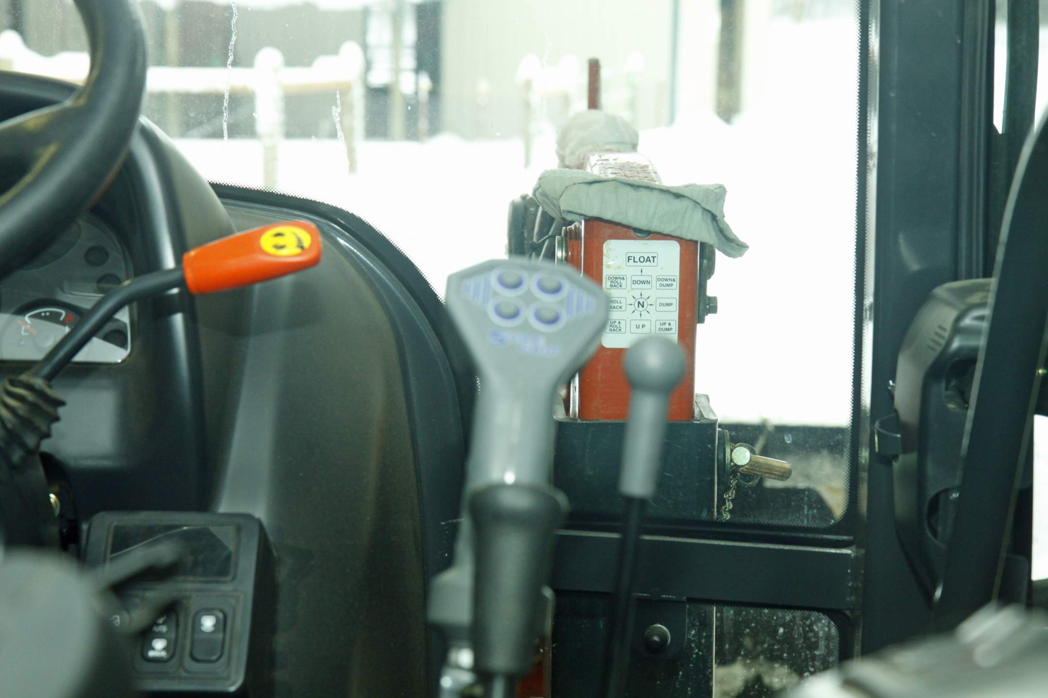

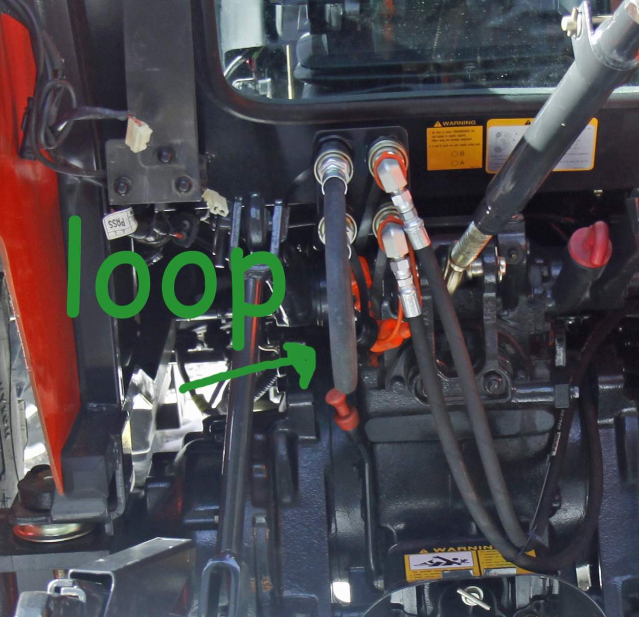

I had my dealer route 2 hoses back to my already existing rear remotes. There is a front mount set of quick connects, and another set where the loader arms attach to the tractor so i can easily remove the loader. I got this at the same time i purchased the tractor, so was pretty cheap...about $400.00 installed.
Buying it separately may be more ??? You can easily do it yourself though. I also made a removable extension arm for the rear remote control handle to have it fall right along side my loader mounted snowblower control.
He simply routed the set of hoses under the rear of the tractor and up the right side of the loader arms, and to a connecting point on the front.
The picture also shows a loop hose that i highly recommend for use when nothing is attached to the rear remotes so you don't accidentally deadhead the hydraulic pump when nothing is attached. The other set of hoses go under the tractor to the front loader. I personally use the front set of hoses on my non-detente set of controls and the loop is on the standard detente set of controls (for post hole digger, etc)
If you need different views, i can take some more pics for you?? just ask

The setup on my CK30hst is almost a copy of grsthegreat. The hoses start from the rear remotes, go down and then forward under the right floor board. A metal mount is added to the original place where the fel QDs are. The hoses come up to the mount where I have QDs for when I take the fel off. The hoses continue from those QDs and run along the right fel arm to another metal mount connected to the fels front cross brace. Here are the QDs that anything hydraulically controlled can be connected to. For the extra cost of another set of QDs and having two sets of hoses over one set of hoses for the whole length just made better sense for me. My fel doesn't come off that often but it sure makes it easy and fast. I purchased the nylon hose covering to keep the hoses from getting damaged and just used plastic wire ties to secure the hoses under the tractor at various points.

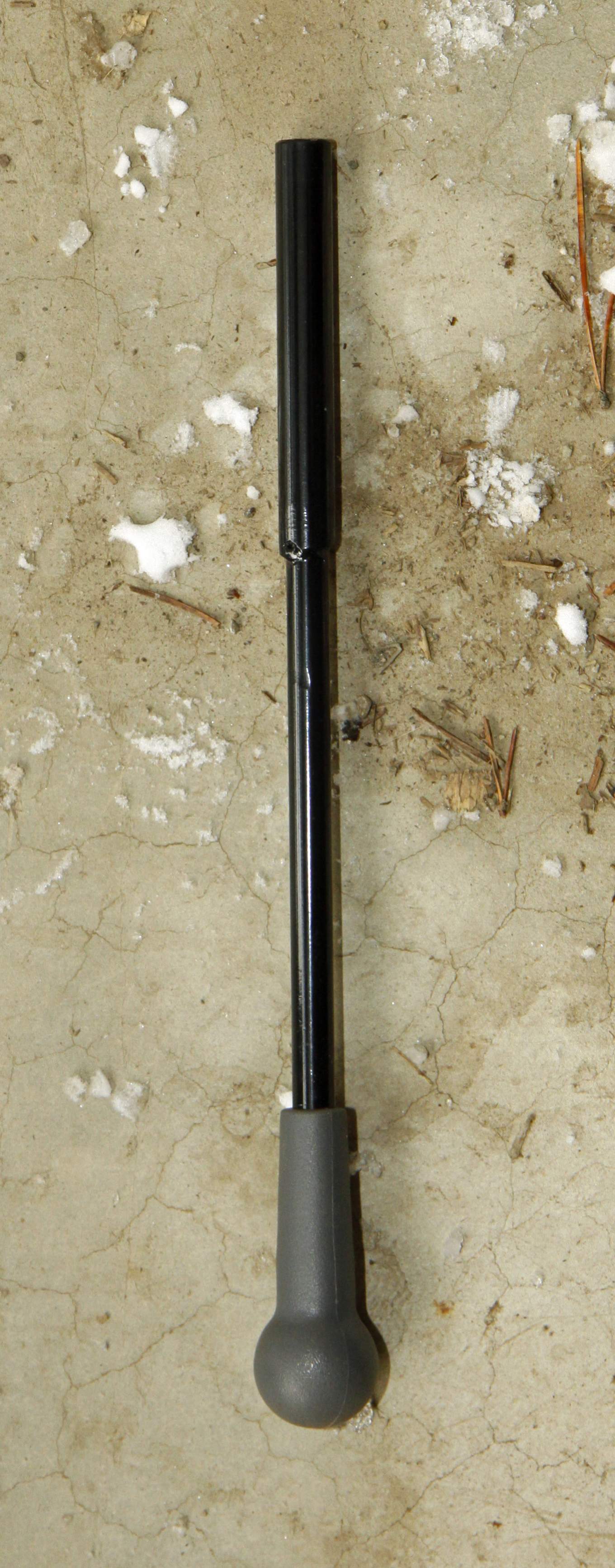

Actually, with the DK series, about $6.00 in steel tube and steel rod creates a lengthened shift lever that brings the rear remote control right up along side the joystick. It works way slick, and when i shift my plow right or left, i cant accidentally rotate or lift/drop my plow blade as its independent of that control. Plus it just slips on and off so you can lose it if your not using a rear remote.
I use this with the remote that DOESN'T have the detente built in.
The big grey control with the 4 buttons is the control for my snowblower chute rotation and deflector.It bolts on the joystick for winter only.
So far Ive used it 3 times...and i am VERY happy with it.
