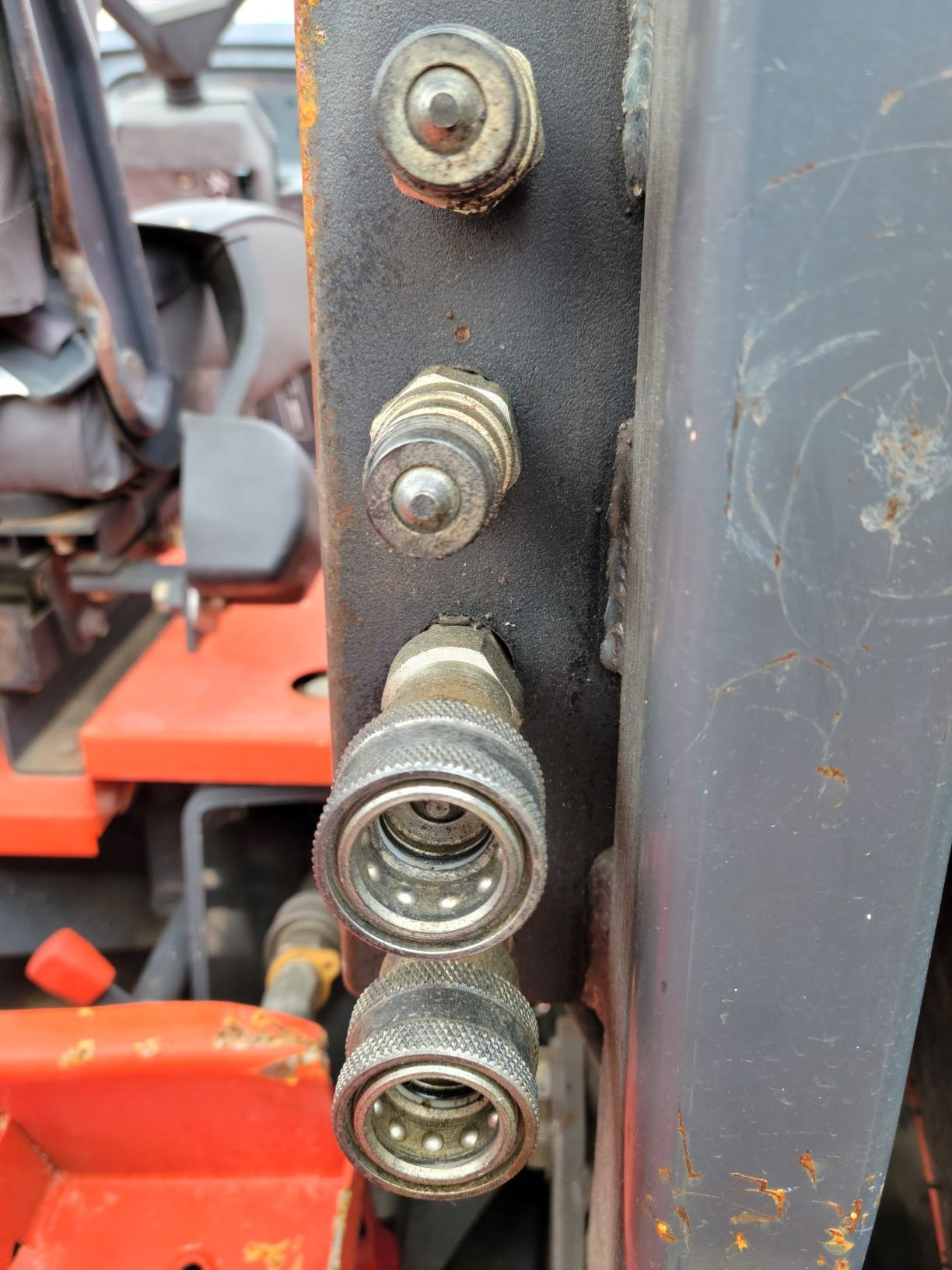

I have just gotten an EA grapple. We are going to use one of two rear remotes for the meantime versus installing a 3rd function. I have attached a pic of the connectors. Is there a standard approach like the male is outbound fluid flow, and the female is inbound fluid flow? I mean, pardon the pun, but that would make sense :). It also looks like they used slightly different connectors (size/shape) to differentiate the two circuits. Just like the first question, is there a convention to the two males and two females being paired like they are?
If I were to guess, I would think the inner male/female is one rear-aux circuit, and the outer two are the second rear-aux circuit?

Update: This is a "Home Brew" setup on the rear remotes with lots of complexity. It is a mess, but I got it working. Apparently the whole value block has flow so there are no discrete circuits as I was thinking to the rear remote. There is a "side valve body", and attached to it in the mix is a single valve. In order to get the grapple to operate, I have to pull this "valve", which is somewhere in the mess. While it allows the grapple to operate, it disables the loader control. If I push it in, the loader control is normal, but the grapple is out of the loop. This machine had one owner, the national forestry service, and my guess is they had some mower attachments or whatever, hence the issues.
I saw in a video that with a third function, you can not actuate the function with loader control (up/down, roll in/out) at the same time the 3rd is engaged. This is exactly the behavior I am seeing, but without a "button" on the loader control. I am thinking it was a Mahindra video. Is this across all machines? @fried1765 @Smokeydog
I will be removing all of the mess soon to return it to stock flows. Thank you in advance.

All the quick connects from the factory I've seen have the female on the tractor side and the implement is all male fittings. No idea why. The dealer added a couple fittings to my tractor so I could run a backhoe, those are a combination of male/female in a configuration to keep the hoses from being reversed and some of each on the implement and tractor.

THe EA did come with male/female connectors. I got it figgered out for the most part. The home brew plumbing from the previous owner will be removed over time.
I read up a bit last night, seems you have to have the 3rd plumbed into the power beyond port of the loader control, or at least last in line after everything else if that does not exist. Apparently, I have the diverter-type of setup. Ain't no biggie, just pull the value, actuate, push back in for now.

Update: The rear aux stuff is 100% homebrew, and after dorking around with it for quite some time, I figured out whatever they used is not compatible as the values were designed for flow versus holding pressure. It is not a stock/orthodox rear aux setup.
SOOOOOOO, it is now with the Kubota dealer getting back to OEM flow with an aftermarket 3rd function....
