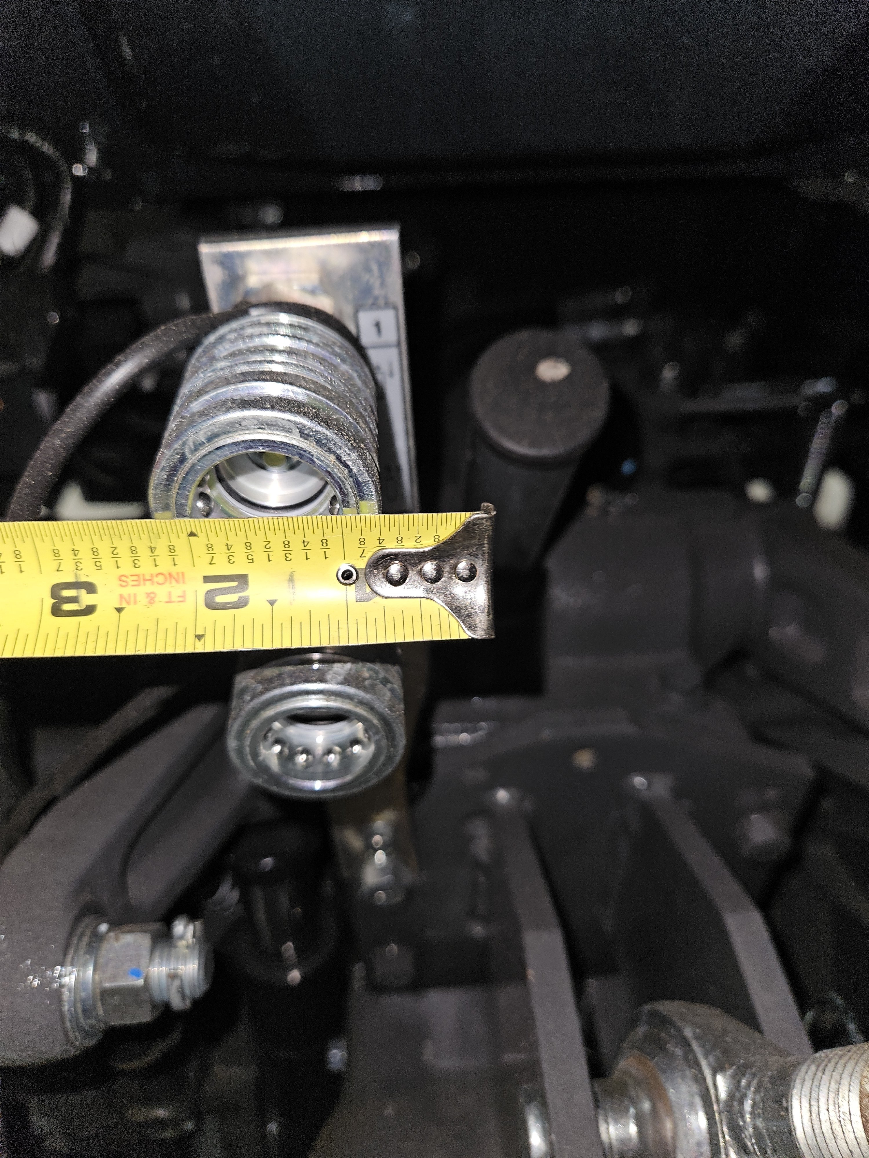

I need to purchase two male hydraulic couplers for the rear remote on my 2024 Massey Ferguson 2860m how would I find out what size these are everything I see says half inch ag coupler for sale dealership has been looking into to it for 7 days now ugh. I want to add the hydraulic top link.

Most all OEM's have standardized in 1/2" ISO 5675 'AG' style w/poppet, but yours look larger than the .80 they should measure.
