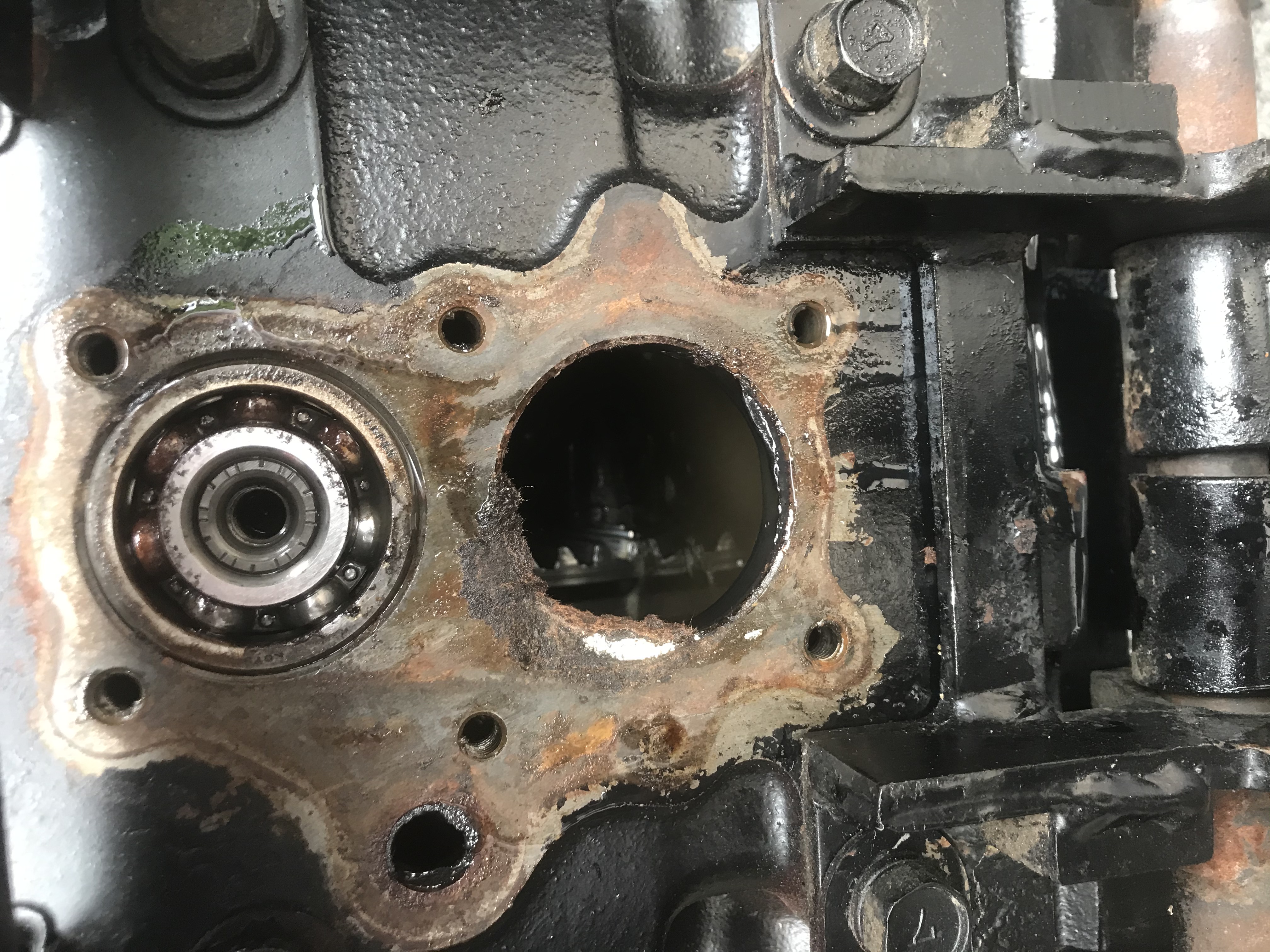

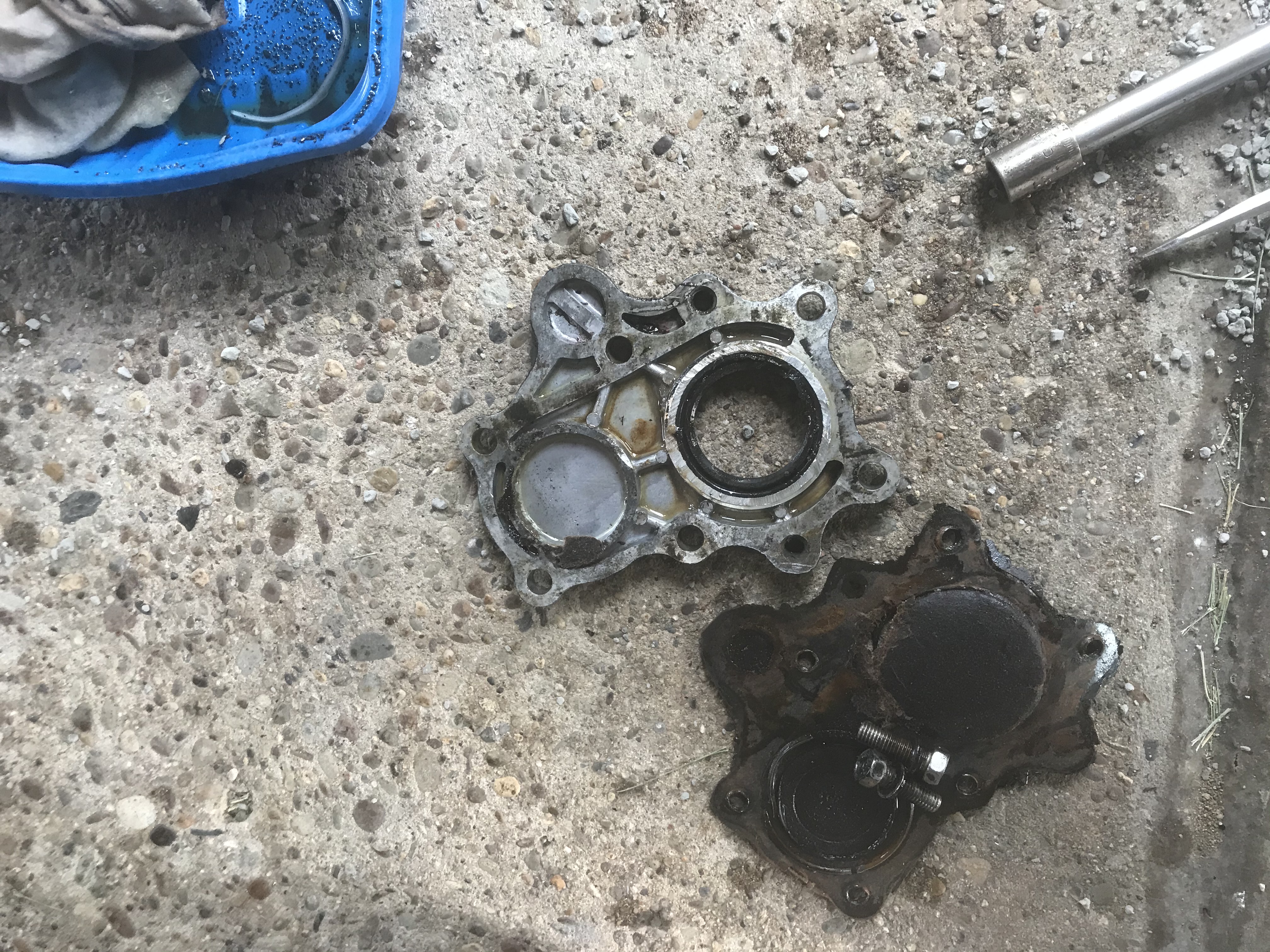

I'm a newbie, and need help! I just bought this 187D and thought that the PTO shaft would be available when I removed this cover. Unfortunately there are missing parts.
Anyone know what all I'm missing...and most importantly, where can I get them?
Otherwise, I just bought a costly tractor just to ride :(

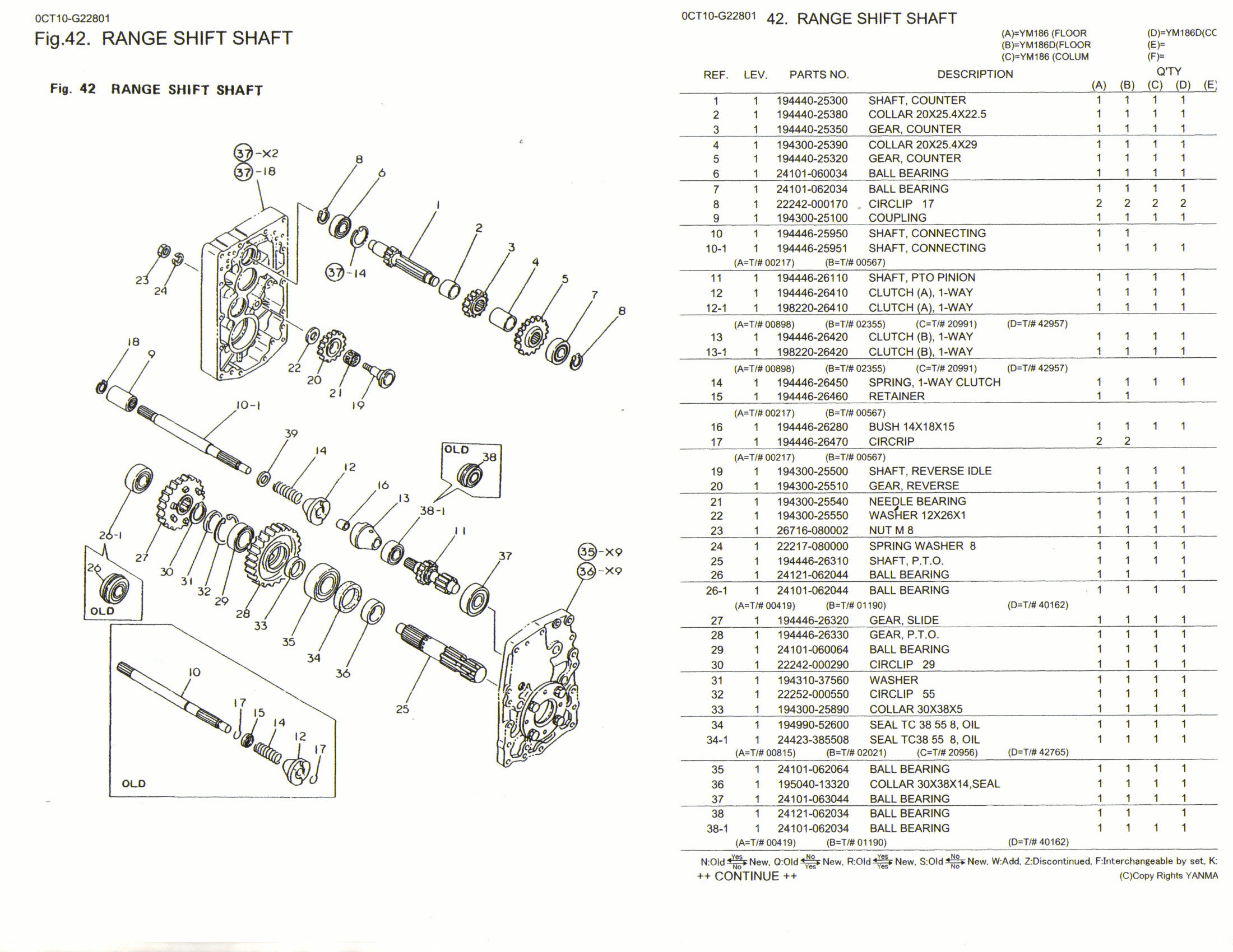

I believe I would inquire from the previous owner if he had any of these parts? This is from a 186 manual. It will be similar to your 187, at least give you an idea what you are missing.

Interesting. That diagram shows a PTO assembly that I think is removable as a unit, like the YM240 PTO in this photo.
In contrast it looks like the upgrade to 187 made everything integral inside the transmission.

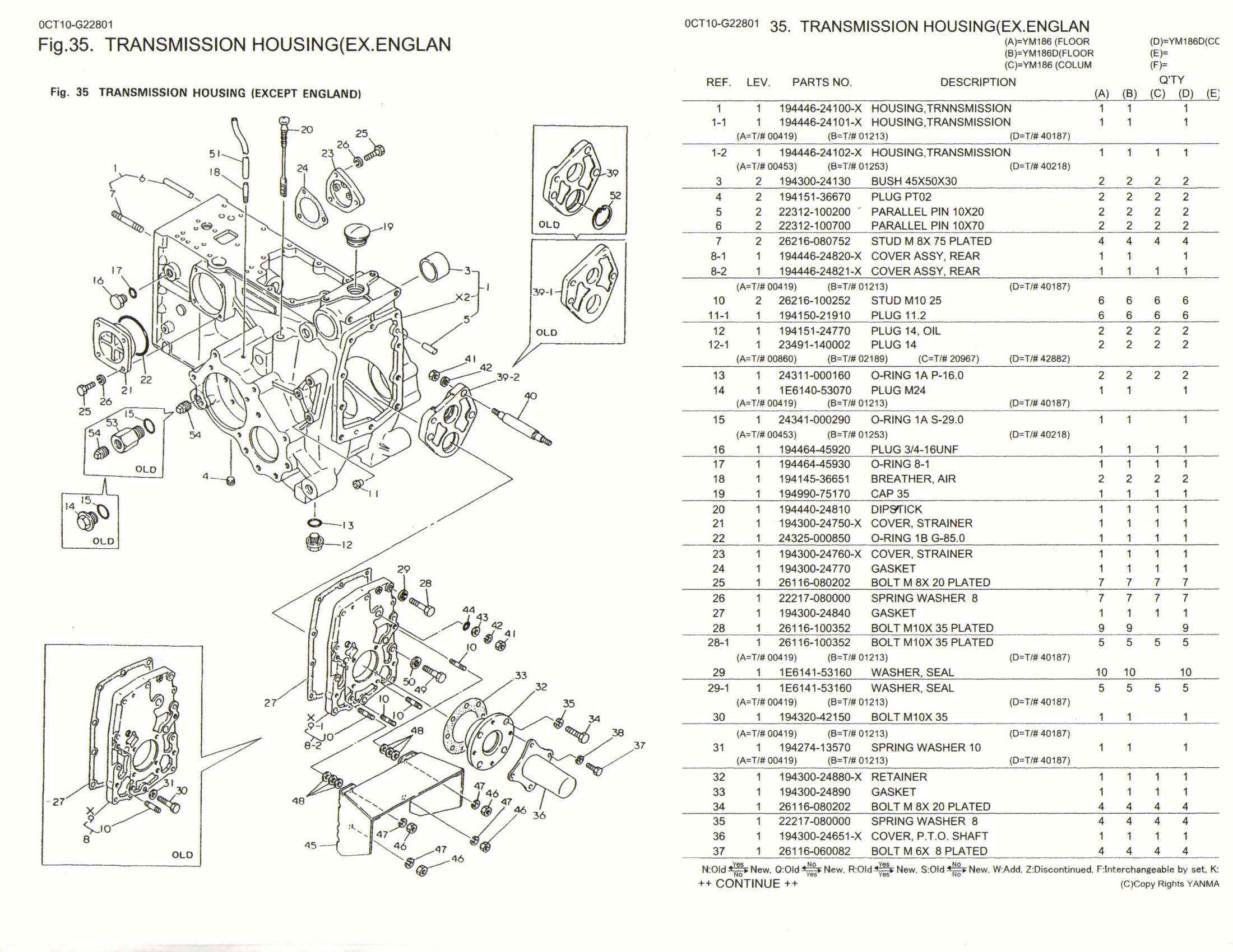

California, I know I am wrong about as much as I am right but I believe the 186 diagram is not a removable unit. whether the 187 is like it I do not know, only guessing it might be.

You're likely right.
A little more research and I believe you are right, it should come out as a unit. It takes 3 of the #40 pto support bolts.
   / Rear PTO #9
And #41, 42 nut and lockwasher out beyond the inner and outer plates. (For YM186D). I'm surprised, I thought YM187 was nearly identical to YM186 with a slightly upgraded transmission but that integral PTO means the transmission is quite different.
