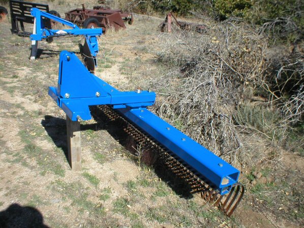

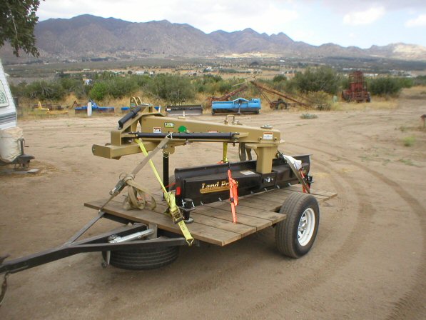

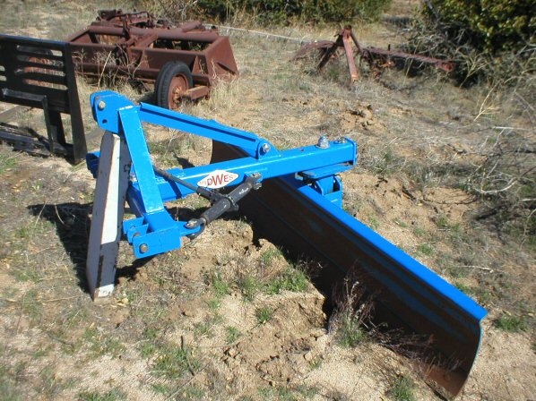

Anything over 6' and you have to unhook to turn around. have a friend that has a 7' he has to unhook to turn it around "it hits tires". He uses my 6' mwst of time.
   / Rear Mounted Blade Size? #4
This may be be true with light duty blades, but on my 96" medium duty and my 108" heavy duty rear blades, the blades can be turned while on the tractor. The booms are longer to accommodate this. Now on my 96" light duty landscape rake, it has to be turned off of the tractor. Sort of hard to tell from the pics, but you can easily see that there is no way that the rake will turn 180 with that short boom. I need to change that.;)

   / Rear Mounted Blade Size? #5
I agree, rear blades, regardless of width, should be able to be turned around without unhooking from tractor. I wouldn't own one that didn't. I have 6', 7', 8' and 10' blades and they all will pivot completely around.
