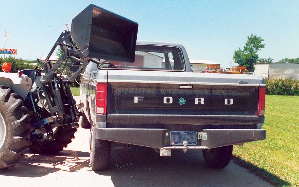

Does anyone know about this type of rear 3 pt hitch loader shown in the attached photo. This particular one is made by Westendorf and the price is quite reasonable relative to a front loader (it's just over a grand). I'm wondering how well it works (light digging) and how easy it is to get on and off. I'd be putting it on a JD X585.

Don't know about anyone else, but my neck would hurt like heck running that thing more than about 15 minutes. Now if you go to the effort to turn your seat around and can SAFELY operate it that way, it might be very good!
I like my FEL since its way out front and I can see it easily (and painlessly).
My two cents.

Notice in your picture how clean the bucket looks and how empty it is? That kinda says something about how well it works. /forums/images/graemlins/smirk.gif I think you could also just go ahead and beat up the fender wells of the pickup with a sledge hammer because they will get really beat up after two or three "oops" with that loader. /forums/images/graemlins/tongue.gif
I just don't see it being used as shown as practical and for moving small amounts of materials and dirt, I'd prefer the 3PH dirtscoop. Even with a loader, it's easy to bump the side of a high vehicle like a dump truck or even a trailer when loading from a FEL that has much more clearance than this little 3PH dumper.

Your 3 point hitch is not really engineered to push backwards with. Might have some bent lower arms and such using that rear loader.

It ?seems? like the 3pt would handle it. No different then pushing with a 3pt blade or pushing with a dirt scoop. I'm sure if you really tried you could do some damage though. /forums/images/graemlins/tongue.gif

Have you seen this loader? I would take a close look at it before deciding. From the photo you attached it looks to me like you have no choice as to when it dumps. It appears to have a chain linkage to the bucket and as you reach a determined height it tips the bucket whether your ready or not. On the site that was posted it also refers to it as an AUTO DUMP. I think that would make it quite non user friendly. IMO

I used a homemade rear loader for a while. I made mine by attaching a 3-point lift boom to the top link attach pt of a 3-point scoop and extending the lower links with angle iron to connect to the lower attach pts of the scoop. Cost was about $400 including a lower link that I broke once on my ford 2000. I used this rig to load a manure spreader about 50 times and it worked well for this. I also loaded a single axle dump truck with dirt about 20 times (it worked but this is where I broke the lower link arm), and a 5-ton trailer with crushed stone about 20 times (also worked good for this). This rig took a fair ammount of hydraulic power to operate (my 8n could only lift the empty scoop) and some front weights to offset the load. I would say that it beats the heck out of a shovel or pitchfork but not nearly as good as a front loader on a fwd (what I use these days). On a 2wd it might approach the efficiency of a front loader as the loaded scoop adds to your traction rather than subtacts like the front bucket.

I have experience with rear mount loaders on versatiles. If you have a reversing controls they are 100x more productive. You can see your work load as the loader is right there. Your vision field is far superior. It also puts weight on the rear of the tractor rather than the front end.
As for the 3pt hitch frame stress. We plow snow with 3PTH mount implements all the time on bigger tractors.
