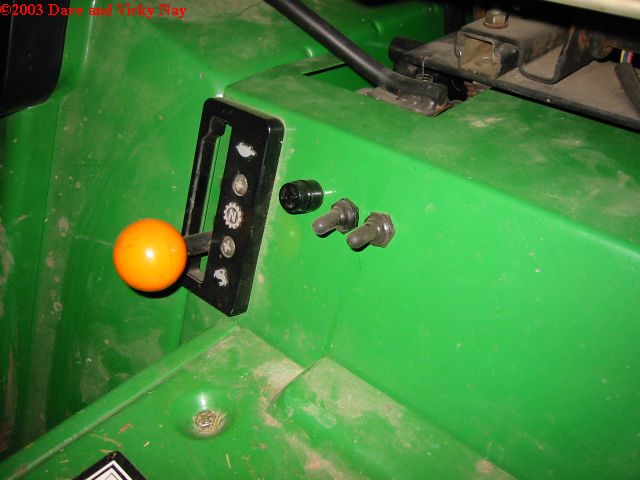

I was originally going to mount the switches for the lights to the side of the ignition key, under the guage panel, but it seems like JD made that panel almost impossible to remove. I actually prefer where I ended up mounting them under the drivers seat. There are two switches, one for each light plus a panel mount fuse holder. I got high current switches, and skipped the relays. The switches are splashproof, and also protected by rubber boots.

Nice job DaveNay.
I also like your switch placement. When I mounted my switches, like and idiot, I didn’t put it in as protected of spot as yours and at the time I didn’t know about those rubber switch protectors so sure enough a couple of weeks ago I really needed them and the switch wouldn’t work. /forums/images/graemlins/mad.gif Now I’m looking for a new mounting place and using the bullet connectors as the switch. /forums/images/graemlins/smirk.gif Time for rev II. Your install gives me some ideas.
