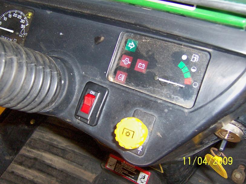

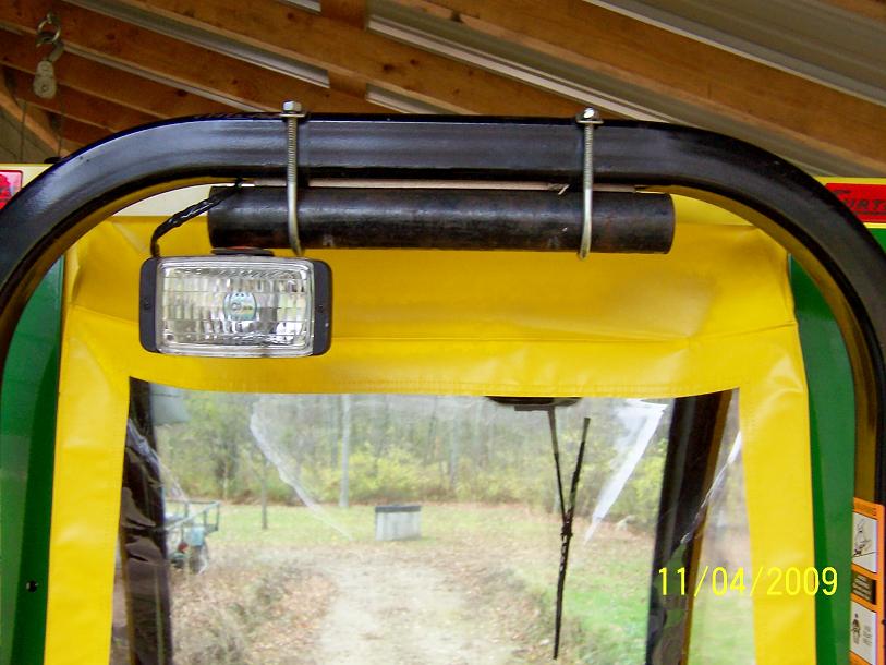

pop:
Here's mine.
I originally had 2 front facing work lights on the bar, tapped into the headlight wiring. When I put the cab on, I used the bar for one rear work light.
The light bar is a 2" diameter iron pipe, 14" long. Holes are drilled near the ends so you can get a wrench onto fasteners. Pipe is fastened with u-bolts with a spacer between the underside of the ROPS and the pipe, so wires can exit the existing holes on the underside of the ROPS. Wiring is fished through the ROPS and follows the taillight harness to the front of the operating station and up into the dashboard to the switch. The switch is located in the blank intended for cruise control. The switch is fed from a tap into the white with red tracer wire that feeds the starter switch (so it is directly from the battery, with an in-line fuse).
The pipe increases the amount of vertical adjustment (you can move the light up and down by twisting the pipe in the u-bolts before tightening. If you don't have a cab, you can rotate the lights to shine forward or to the side. This mounting does not increase overall height, if you have clearance problems.
