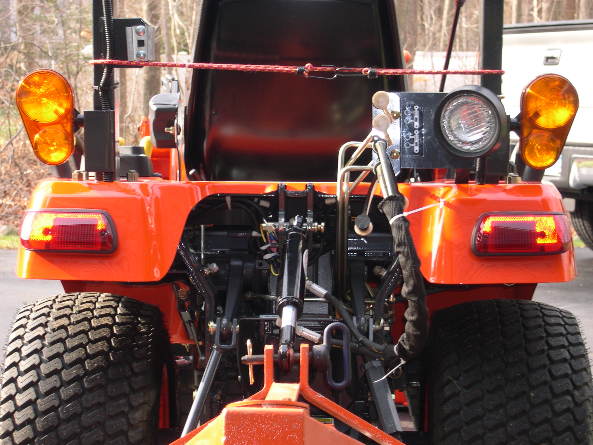

With respect to original poster, can I jump in and ask further about rear hydraulics. I have a BX2660 2007 model , I plan on getting a rear mounted snow blower next year , but one aspect to decide on is whether new hydraulic line can be found to run to the chute rotation and or the chute up down . I hear one way is to just make an extension hose and disconnect a line to your bucket and with extension send it to rear to plug into snow blower chute system or leave as is and buy the electric chute option...or maybe there is a third option like original poster is asking that I can find a blank port under the rear area and some how run a new lever up beside my rear operation levers.
Kubota makes a slick dual rear remote kit for the BX series, except the BX24/25. I know because I put one on my old BX1860. The kit cost about $300 back in 2008 or 2009. It can be ordered through sales as it is wholegoods, not parts. the levers for the remotes go in the empty slot to the right of the seat. There are some old threads here on adding the kit. Here's a pic of my old bX1860 with the rear remotes.

   / Rear Hydraulics #8
thanks CHD I will keep that in mind
