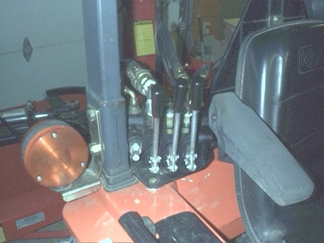

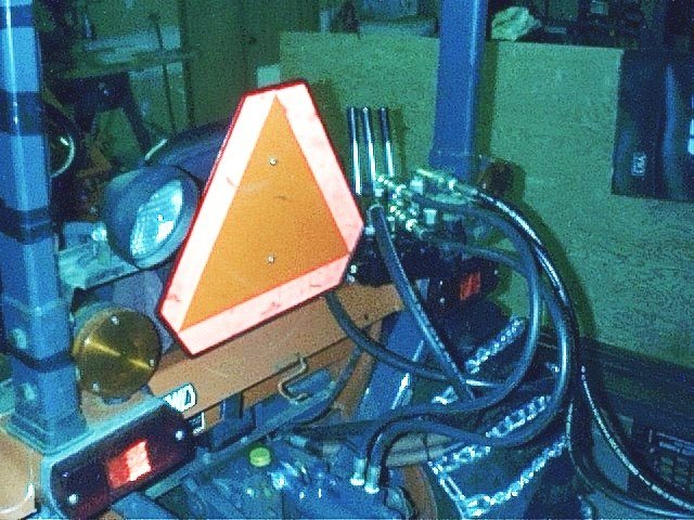

   / Rear hydraulics for a B2150 Kubota? #8
The solution to your problem is simple. For the Kubota your valve block must be open center with power beyond and it should have 3-position 4-way spools and the inlet should have a pressure relief set at least 2000 psi. I believe the hydraulic flow is about 4.5 gpm so a small valve will be ok if you can find one. I used a Prince SV which is 12 gpm but only has a footprint of 8" x 8".
You should not have to remove the loader valve. Disconnect the loader's power beyond hose from the front hydraulic outlet on the tractor. Join this hose with a new hose that goes to the inlet of you new valve (you can also replace the entire hose). Then run a hose from your new valve's power beyond port to the front hydraulic outlet.
Locate the loaders return to tank port hose and determine where it goes back into the transmission reservoir (probably under the seat). Install a Tee connector here. Connect the loader hose to one side of the Tee. Run a hose from your new valve's outlet port to the other side of the Tee. This part of the circuit normally has no presure so a Tee will work fine.
Start the tractor. Add hydraulic fluid as necessary.
   / Rear hydraulics for a B2150 Kubota? #9
here is a rather grainy picture of my setup.
   / Rear hydraulics for a B2150 Kubota? #10
And another.
