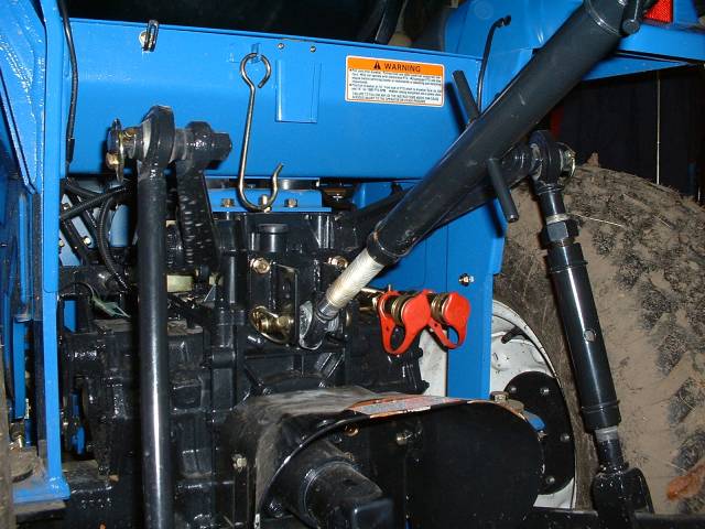

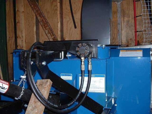

I spent an extra $500 on my TC-24D for rear remotes 4 years ago, only purpose was for the hydraulic chute on the blower. By far the best $500 I spent on the tractor. Remember, you're going to be facing backwards. I have tight spots and change direction constantly - would not be without it. Imagine trying to crank on that with ice build-up and blowing snow during a storm. I have the Woods SS-52 on mine, really like the hydraulic motor/sproket sytem on the chute rather than the hydraulic ram/cable system found on a lot of the other ones. I have some pics if you're interested.

Pics of my remotes and the blower with the hydraulic chute. I could have had the electric version then as well, but the dealer said the hydraulic was a better bet for harsh conditions over the long run. His opinion anyway, I went with it and am very happy with the set up.
