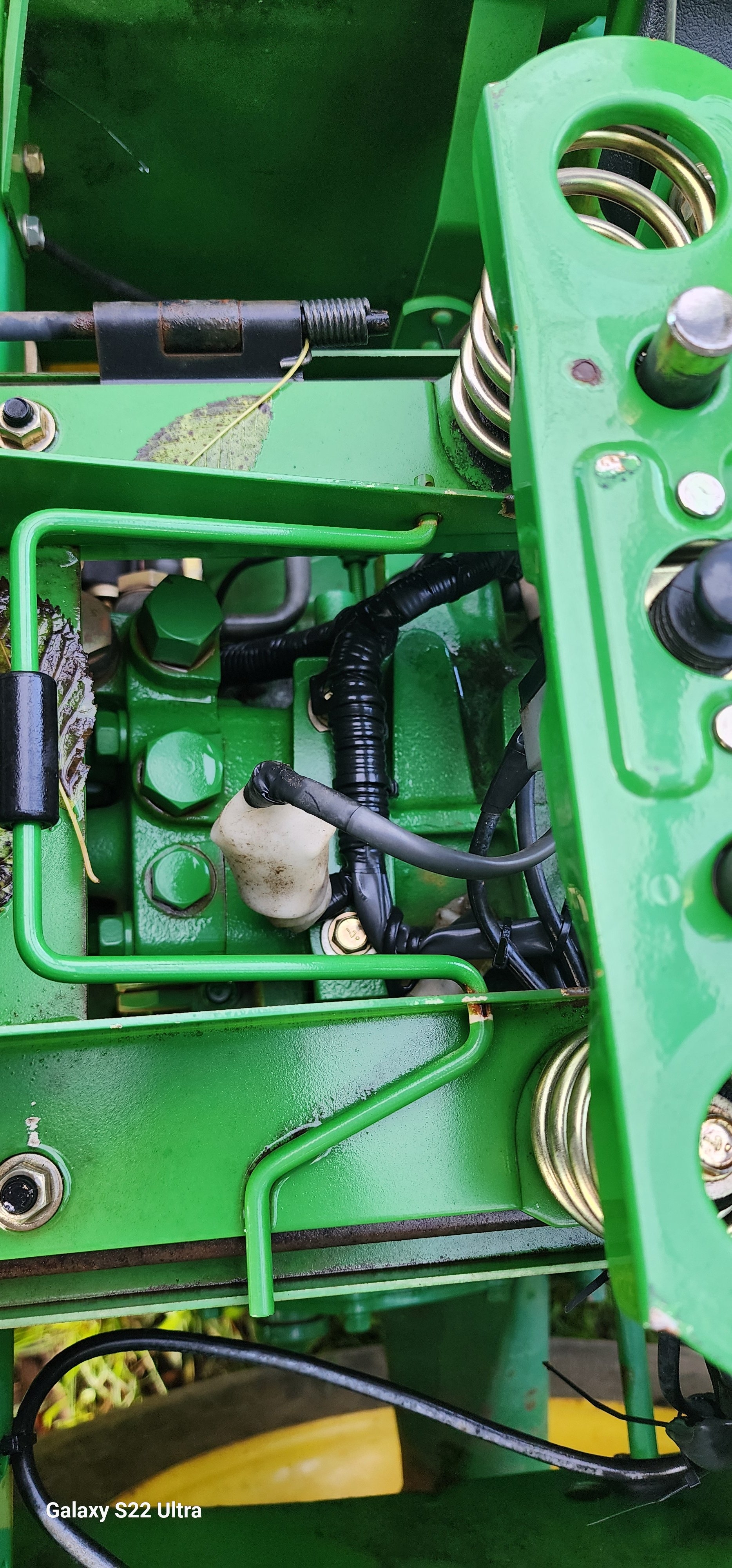

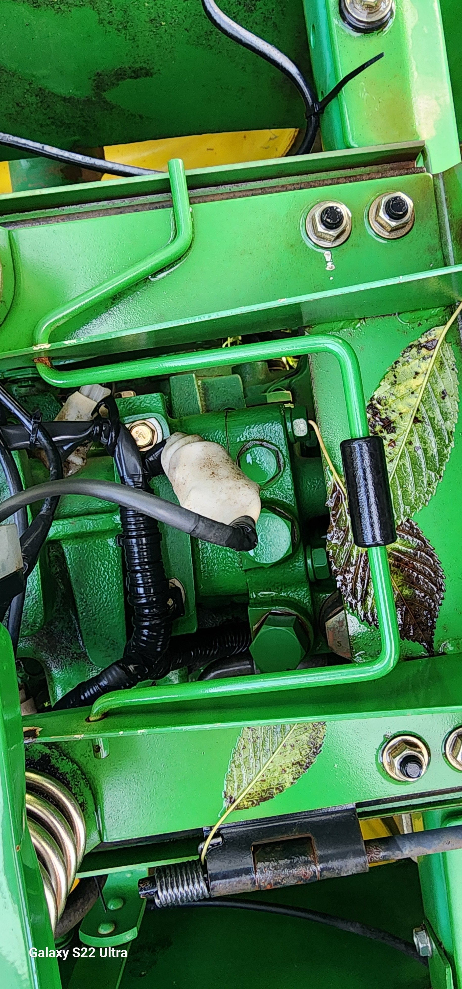

2007 John deere 790
I have a john deere 790 compact tractor with a front ladder bucket. There is no hydraulic lines on the rear to hook up a backhoe attachment.
What would I need to do to add a hydraulic hookup on the rear? Also if possible could I use a john deere 48 or 49 backhoe attachment?
Thank you for all your help!

Can't help you with the what BH to get, but for the hydraulics you need a "Power Beyond" kit designed for your tractor to run BH....
One of several "kits" out there....
