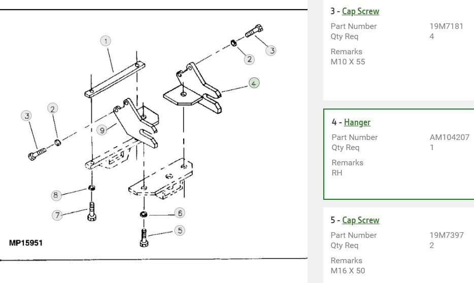

Been looking for the rear hangers for a #7 backhoe for my JD955. Parts are obsolete. So far no luck in the used market. Wondering if anyone has had the same issue locating the parts or hanger specs for a 955/855/755. I’d be interested in knowing how you solved the problem. Thanks

Found part numbers in jdparts.. and a search shows some available. Your location in your profile would help answer your question too. ;)
Looks like might not be hard to fabricate.. if they look like this..

Yes, I thought I could get one of them too because they show up on several websites but unfortunately after going to three JD dealerships and ordering the “available” part online, no hanger. Fabrication may be my only option. Thanks beenthere

Simple....... I bought a Bradco hoe with skid steer mount. Fabed a mount for the TC55 including the lower brace to the front axle. Works great. Mounting system was over 5k, tractor and hoe attaching parts. Its amazing what a mig welder and band saw can do with $300. in steel.

Thanks for the suggestion Agent Blue. I will add it to my list of options.
