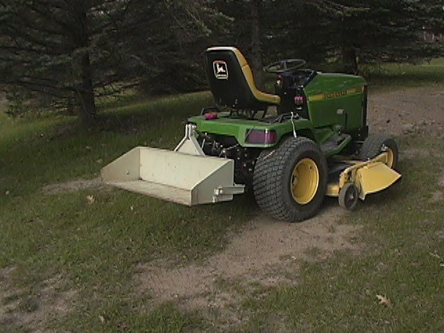

I use an earlier X - 455 to do these tasks. I run a 6" landscape blade. A box blade is better at relocating material. You might look at a front scoop as well. See ads on www.weekendfreedommachines.org I bought a rear 3pt scoop but sold it as I thought it too light & easily bent. The 455 could load heaping loose gravel where the scoop would un hook & dump the load when hitting a bump /forums/images/graemlins/confused.gif
