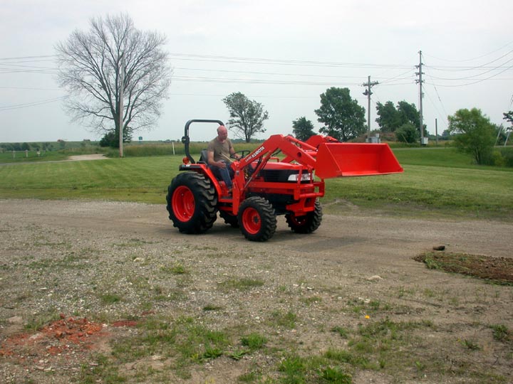

Thanks all for the input but still looking for more. The good the bad and the ugly. Post em for all to see. If you like something boast about it, if your not keen on one or the other rag them here, if you had a bad experience now is the time to voice it. Anyway I emailed First Choice but have not received an answer yet. Does anyone have their web address or phone number? Also still would like some input on the gearboxes out their. Is there a substantial difference in them or are they all pretty much standard. On a side note Baby did arrive at her new home this afternoon. Had the wife and kid shove me up on the doggonned thing and went out and dug me a 100 ft trench thru bricks, blocks etc. I really had hoped it would dig better but I think that will come with experience and a tooth bar. Anyway here is a pic. Thanks to all of you for your advise because without it I would not be tractoring yet. You just gotta love this site.
