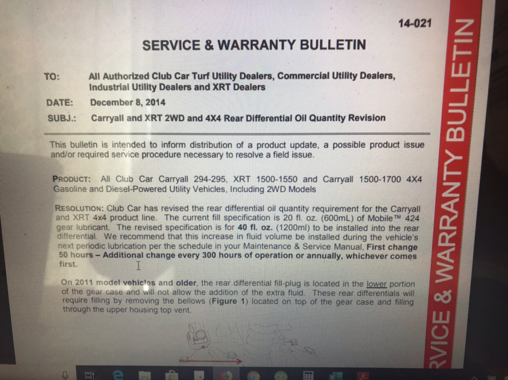

One of the contributors on the other message board that I linked earlier has posted the image below. It shows that Club Car has doubled the specification for fluid volume in the rear differential for all model years, presumably in an attempt to reduce the failure rate. I have no idea if Bobcat, New Holland and Husqvarna have done the same.

I recently bought a 2016 Club Car Carryall 1500 with 870 hours that had it's rear differential replaced in 2017 with 470 hours on the cart. I am changing the differential fluid now and am unsure about how much fluid to add. I have a the 2016 owners manual and it says 20 oz. The bulletin you shared shows 40 oz. My manual is 2 years newer/current than that bulletin. I drained the old fluid out and it measured 48 oz.! Whoever filled it up last must have used the filler port as a level indicator which my manual specifically says not to do. Its says fill by volume=20oz. I wish I could get an official update on how much to add. Do you have any more info Chris? Thanks! Eric
