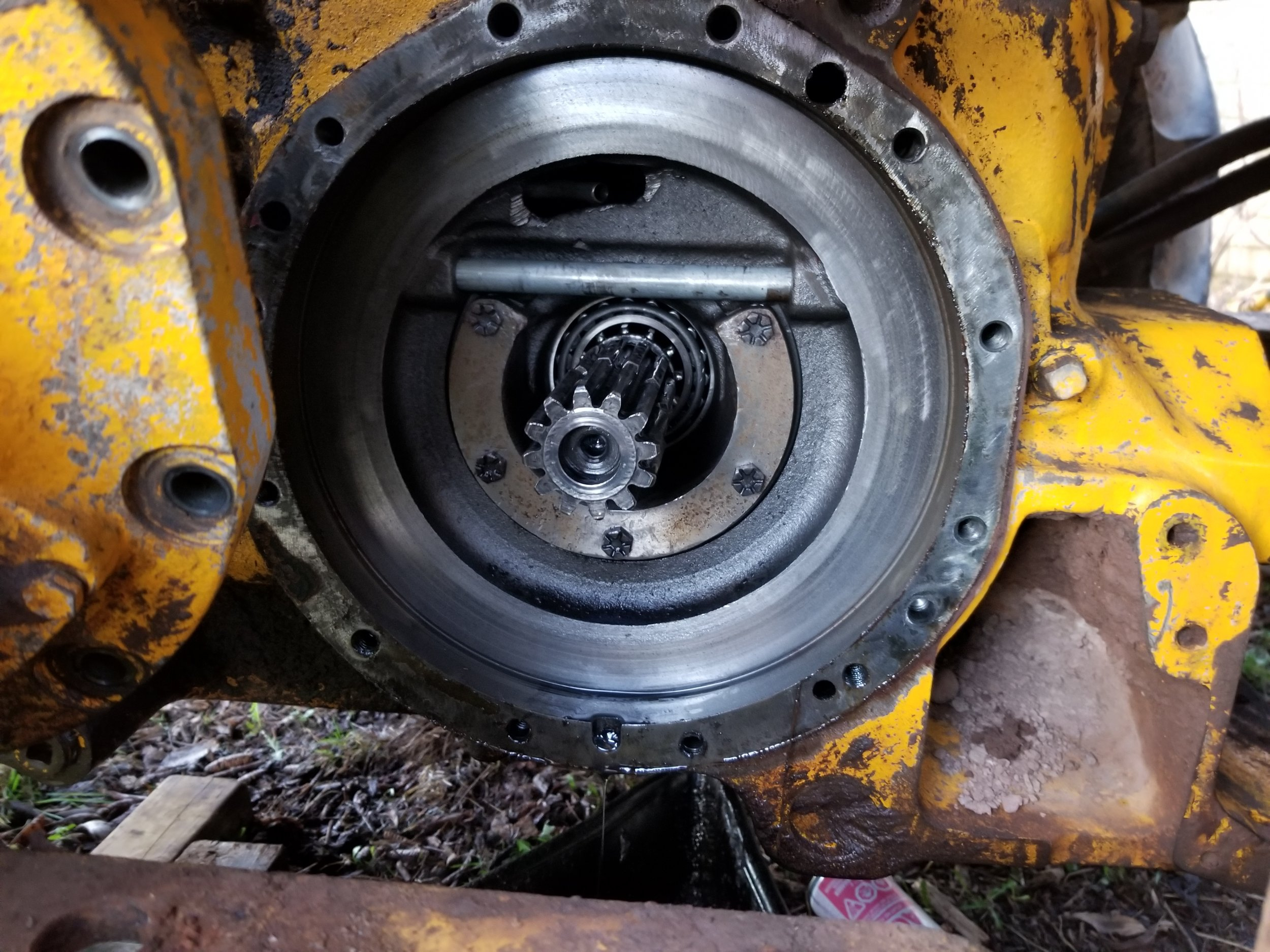

The axle in my 410 has been locked since the day I bought it.
The first hint I had something was not right was the green paint on the left axle tube.
I has a suspicion that something bad happened on that side and messed up the diff lock and when they replaced the axle tube, they didn't replace the fork.
I was hoping it was just a case of the fork was messed up when the incident happened and they just locked the collar in place.
I opened it up tonight and this is what I found, no collar.
At this point I have to assume some SOB went through the effort to weld the spiders up instead of replacing the fork and collar.
Anyone else have a different diagnosis?

Sounds as if a visual inspection & possibly R&R of 410 differential is in your future.
   / Rear diff lock on 410 backhoe #3
If you are lucky they only welded the unmeshed teeth of the spiders, not the spiders to the gears they mesh with.

I slept on the dilemma and I can't come up with any other possible explaination.
I priced out my options when it comes to the spider gears this morning and I think I'll bolt it back up and run it as is for now. I was hoping to make the machine roadable so that I could drive it to my other properties, but I'll deal with that problem at a later date.
