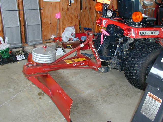

I currently have a 5ft. "Bush Hog" rear blade for my Sub-Cut and while it does a fair job leveling dirt, etc., it just dosen't seem to have the weight to level gravel....doe's anyone out there use a heavier rear blade on their sub-cut and do you like it ...what brand....cost????

Put some weight on it. Adjust the top link so the blade cuts rather than drags.

It's not the best picture, but I had a local welding shop weld a simple post setup that would accomodate 25 lb. weights. It's worked great!

That's a good setup. There are many times one needs a little more weight with a blade.
I think the others are correct, orignal poster needs to angle the blade properly with the top link to move the gravel. Just experiment changing the top link until you get what you need, and then add weight as needed. John

I too agree with the adjustment of the blade angle with toplink. What the weights have come in really handy for is clearing snow (in reverse) so I don't tear up the gravel drive.

Thanks for posting that picture! I have need for adding weight to a disc, and didn't have a good plan. I also have several old weight sets (since I'm too old and decrepid to use them as they were intended). Now I have a plan!!!!! /forums/images/graemlins/grin.gif
And with the weights on the disc, the Mrs. will quit harping on me to USE them! /forums/images/graemlins/smirk.gif /forums/images/graemlins/crazy.gif
