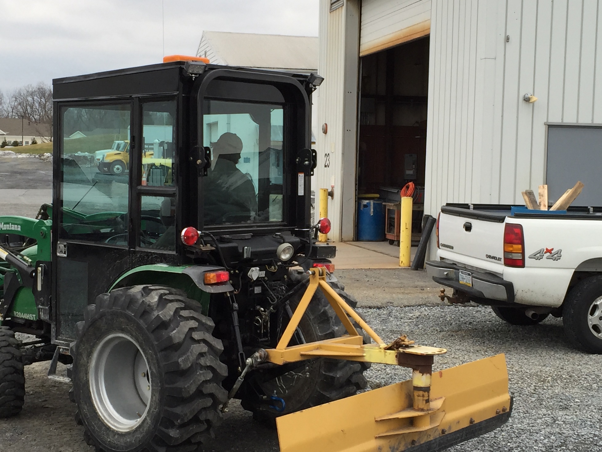

Hi I am in the process of getting a rear blade 60in land pride è¿*B1560 I am curious if it is what I need or just falling into sales gimmicks.
I am going to be installing patio15x10, walk way 25x5 and fire pit area roughly 15x12 all with pea stone. Also In the winter I will be using the FEL for snow removal and figured a rear blade would be good to finish it/clean it nice after the bulk is removed.
Am I thinking correctly for leveling the 3 areas and for snow removal? Would the rear blade do damage to my new driveway? (Paved driveway) would you recommend doing something to the blade or a specific pitch for it to avoid damage?
Thanks for your help

There are much bigger and heavier rear blades than I have. None of mine would cut into dirt or even move it much, but they'd all spread gravel. There have been two projects that required cutting into and moving earth. One was when a couple hundred tons of old volleyball court and "yard" was relocated (used FEL), and the other was re-grading an area of roughly 150' x 50' to make it slope in the opposite direction (used box blade and FEL).
A 5' rear blade was my only snow weapon for 10 years. It did my 300' driveway, another just like it and a few shorter ones. Mine never damaged blacktop. It does sorta scrape the blacktop and make it look more gray. I always set my adjustment so the blade was perpendicular to the driveway surface.

There are threads on TBN about softer cutting edges for blacktop:
  • Rubber Cutting edge
  • Polyurethane Cutting Edge
  • Cut groove in PVC Conduit and slip it under the cutting edge of the blade
You will like having a rear blade.

I like the PCV conduit idea. I wonder if the blade in "float" would just slide along the blacktop or gravel while picking up snow. Possibly a smaller diameter conduit - say an inch or less - perhaps with the ends capped for a bit of extra strength? How long for the abrasion to wear through it, though? Interesting.
