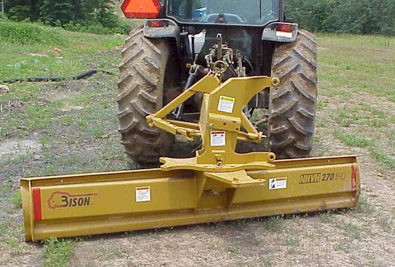

christy,
I bought a wimpy little rear blade (see attached).
I use it for road maintance and ditching.
A box blade would probably work just as well for most of the road work.
However, the rear blade is ideal for forming drainage ditches. A box blades' end plates would get in the way.
It also makes a pretty good bull dozer.
Around here we take the aproach that god provides the snow so god will take it away. Besides we don't get very much so this is not a major use.
