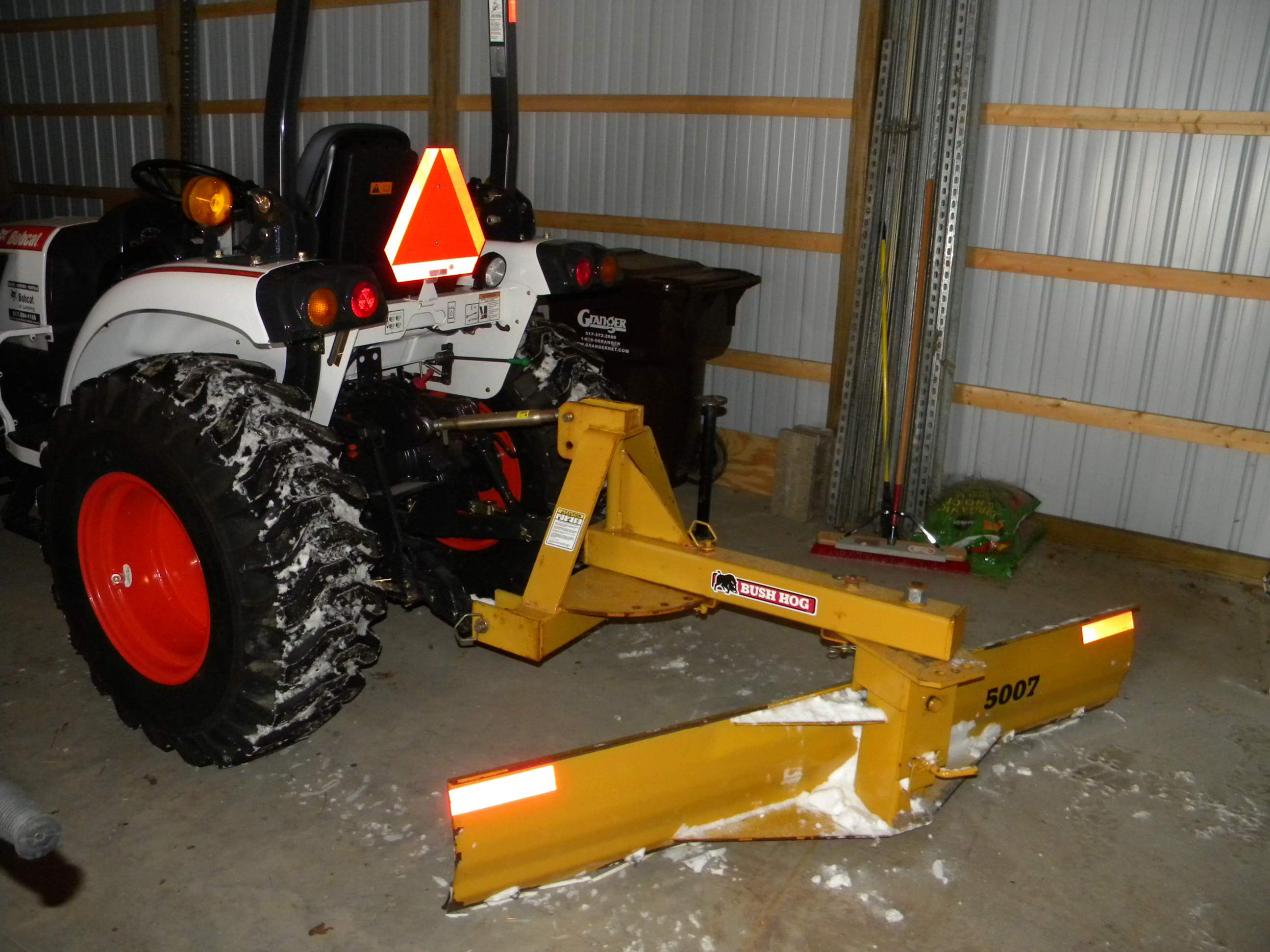

Tilt and offset can come in handy. If you are interested in a 3rd option that would include both features I'm selling the one in the attached picture for $600. I'm about an hour north of you. bh5007.jpg

Milkman. That's a nice HD blade! I'm mainly going to use the blade for snow removal. Will also be getting a box blade and landscape rake for my other projects / maintenance. I found the lighter blades work best for my gravel driveway. I think yours will dig down too much for me.
