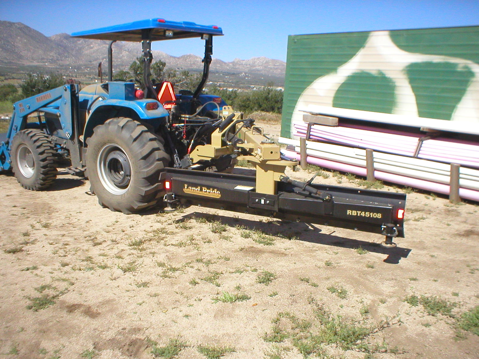

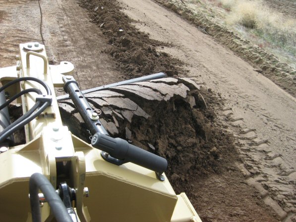

Whatever blade you end up getting, be sure to get skid shoes with it. They really do help out, a lot more than I ever thought that they would. :thumbsup: I love my Land Pride blade, one of the better implement investments that I have made over the years. ;)
   / Rear Blade Size
#9
That sure is a nice looking setup you have there. Congrats.
