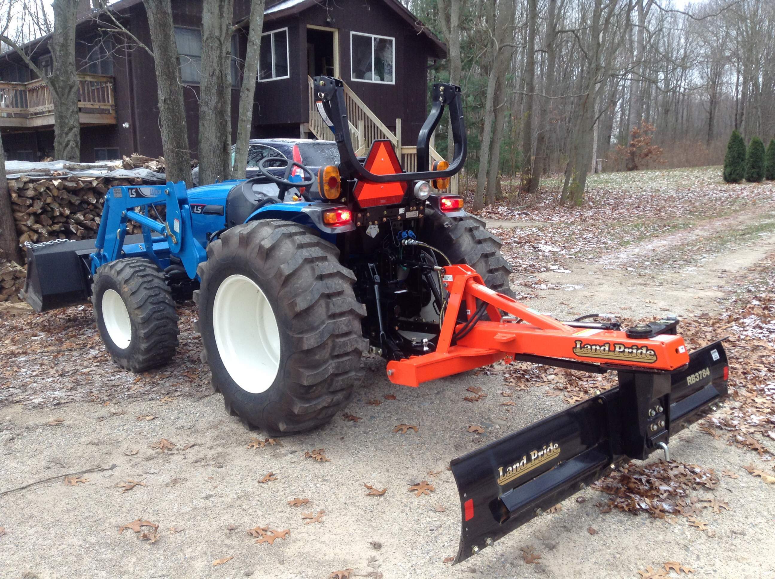

I am a new owner of a LS R4041H and shopping for a good rear blade. The tires are 6' apart, is a 7' blade the proper size when angled? I will mainly be plowing snow, grading driveway and some scraping in the woods. Suggestions on make & Model #s would be appreciated, Also any body have any experience with "Everything implements Super Value Blade" ? It looked like a pretty good set-up. Thanks

A 7' blade will be a good match. My tractor is also 6' wide and I have a 7' Blade. A Woods HBL84, Tufline GB4-84, Everything Attachment extreme duty blade or any probably any blade that is 550+lbs. The EA value blade will not be enough for your tractor.

If a 7' will cover my tracks When angled I would go with the 7' because I do a lot of work in the woods and get into some tight places. I seen a heavy duty TRI Red 7' on EA Web site , 445 lbs. for $898. What do you guys think?

I would stick with a 7' blade unless you step up to a heavy duty 8' like this. RBT35 Series Rear Blades | Land Pride
I had a 6' Tufline GB472 when I had the Bobcat. It weighed 550lbs. After I got the L4240 I wanted a 7' blade and I ran on to a Woods HBL84 and it weighs 550lbs. At a quick glance the blades looked identical but they were completely different. I guess somebody copied somebodies design. Going from a 6' to a 7' blade I can tell that the blade is weaker, you have more leverage. I can also tell a difference in how the blade cuts. The old 6' blade was more pounds per foot. A 8' blade of this style would be weaker and I would not want one on a tractor this size. A 8' blade would not weigh as much per foot either. If you want a 8' blade I would step up to some like this. RBT35 Series Rear Blades | Land Pride
