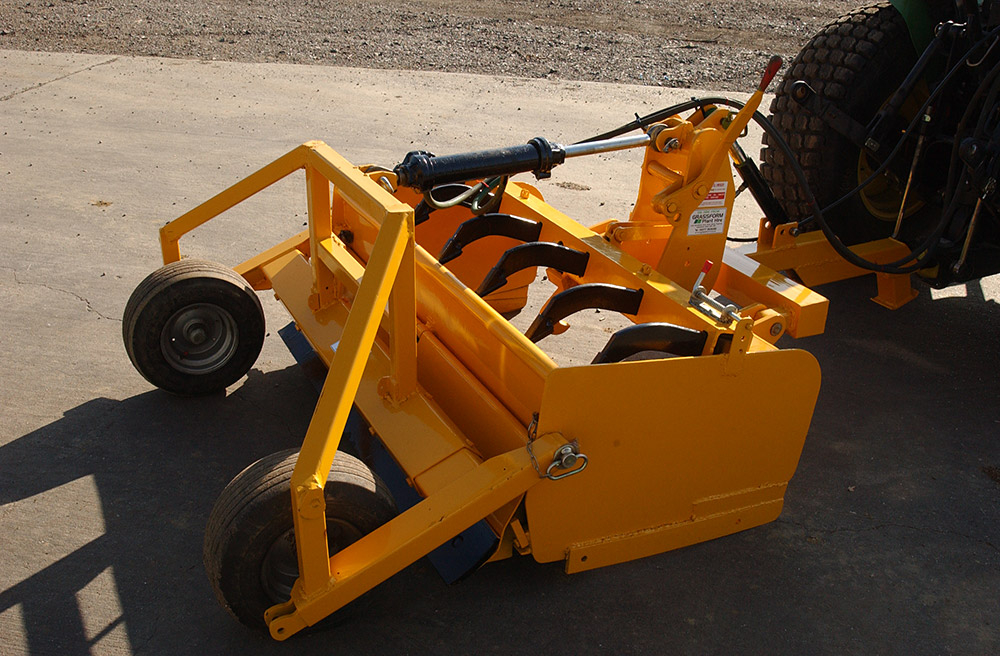

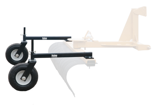

Most of the ones I have seen have two wheels: landscape rake wheel kit - Image Search
   / Rear blade/rake tail wheel
^ thanks, yes I’ve noticed the majority of rakes have 2 gauge wheels. I’m making this to be interchangeable from my rake to my 8’ blade.

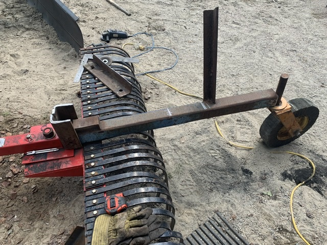

Got started with some scrap….
The vertical angle iron was already there, but may be in just about the right spot to mount one end of the cylinder…. If I need more or less travel I can mount it higher or lower :)

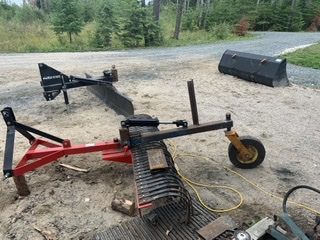

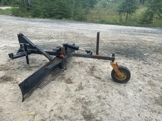

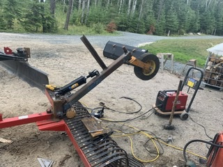

Got it almost all set up. Interchangeable from rake to blade. Wheel height could also be shimmed higher or lower if need be. One wheel will allow the rake to be angled for crowning road. (Have to make a hyd side link now!)
Hopefully local store has some adapters so I can use existing hoses and give it a go soon.

Finally had a chance to give the tailwheel a try. I set it up on the rake and moved a bunch of sawdust/bark junk across the yard.
As I went in and out of the depressions and over bumps the rake stayed more ‘level’ and worked great, moving only the material I wanted. Took some fiddling to get the wheel set in the right spot, relative to the 3pt height and the top link adjustment. Well worth the effort. Hope to try the blade later this week.
