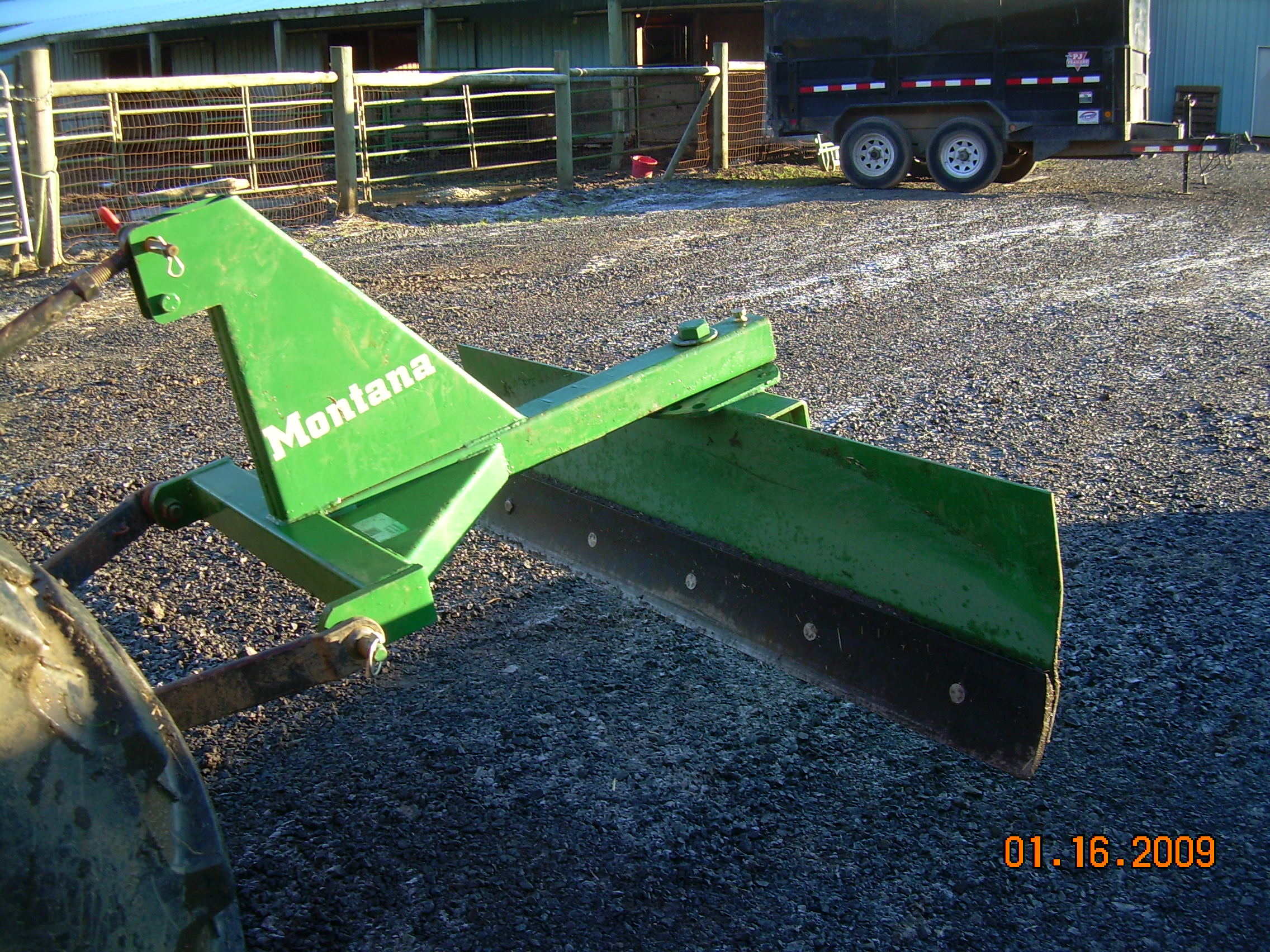

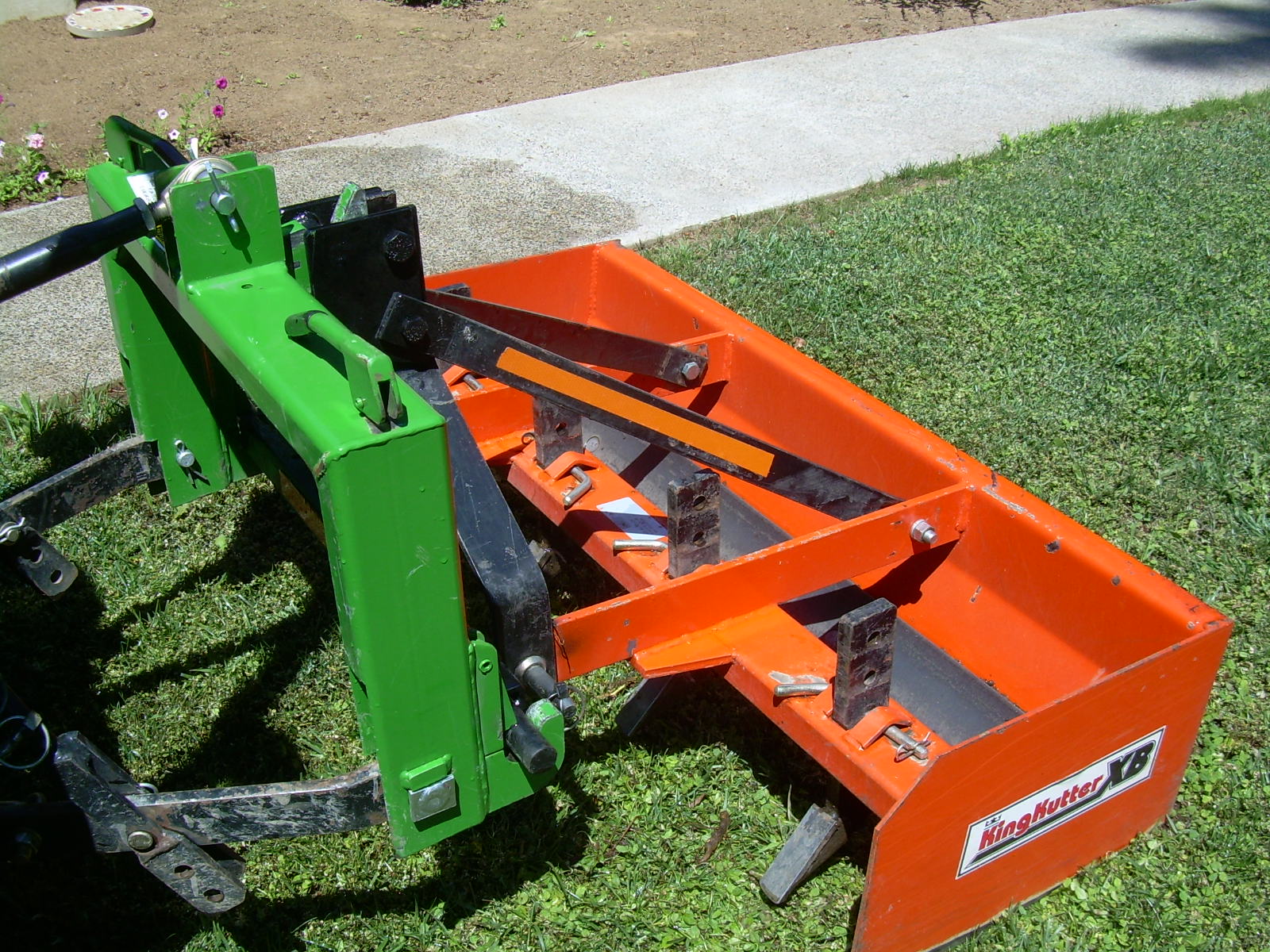

I have a boxblade and a rear blade. They both work great!:D I purchased the boxblade first and was happy with my results. I mostly pulled it behind a JohnDeere 2210 and the other times, a Johndeere 3720 with FEL. My boxblade is so popular that my aunt (who lives next door) always asks when am I going to use the boxblade on her driveway again. Luckly, the wether is improving so that is what I get to do tomarrow. Yay, seat time!:p The grader blade is about 2 months old and does graet on my dads driveway! I go up one side and down the other and it still takes about 20 minutes. I would reccomend the boxblade as a first because with my experience of owning one, it can do more than you would expect. I am one of a kind in my neighborhood because there arent very many 13 year olds that buy tractor implements.
