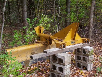

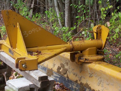

I picked up this blade this summer. It was new-never used-but must have been sitting out for years. I purchased it from an old time dealer. He has to be approx. 80, and very sharp in the head. Has acres of "stuff". I located it by phone and had to chuckle at his reply, when I asked ""who made it?". He said in a more than slightly aggrevated voice. "I don't know, what does it matter? It is rugged and you won"t be able to damage it with your 65 hp tractor." He doesn't like to waste time on trivial things. /forums/images/graemlins/grin.gif
There is no brand name on it. Sticker on front is from a epuipment reseller that he must have got it from.
Well, he was right. It is very rugged. The turning plates are 3/4" thick. the blade is 1/2", and reinforced quite a lot on the back side.
More pics below.

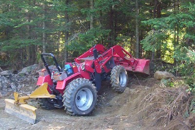

My rears are about 7' wide at present. The blade is 8'. Worked real well. Can turn it 360.

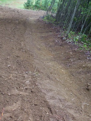

This is a ditch that was made with the blade. One pass and there was a 16" -18" deep ditch. The pic shows it after I smoothed it out with the loader bucket.

I also was looking for a BB. However I discovered that this blade will suffice for me.
It is quite heavy, so...I have been visualizing some ripper type teeth attached to the bottom of blade. Also, a bar of some sort with RR spikes welded on.
As you can see by the pic., it is also a "safety" device in case you should happen to pop a wheelie.
