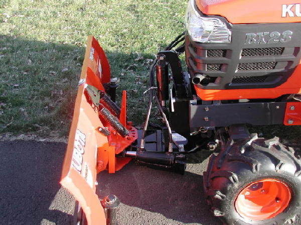

I have the 60" front blade on a BX23. This is a great setup for moving snow. Had no problems in a recent 17" snow. You would need the front mount quick attach. If you go for this setup make sure you ask for the hydraulically angled heavy duty blade as opposed to the manual angled light duty blade. The blade is cheaper than a snowblower and the BX24 should already have the 4 way joystick valve. I have used the rear blade in the past and the front blade is much easier to use especially with the hydraulic lift and angle. You can even buy a rubber blade tip for this setup if you do not want to scratch up your driveway. The front blade has springs on it that allow some give if you hit an obstruction.
   / REAR BLADE for BX24 right tool for job? #5
Here is a picture of the front blade.

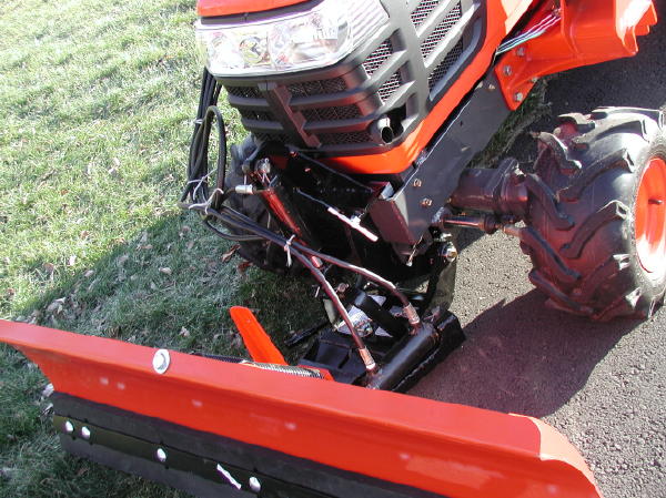

   / REAR BLADE for BX24 right tool for job? #6
Here is what the rubber blade looks like

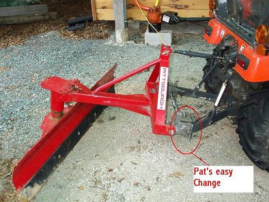

Noviceguy,
Attach is a photo; I have the blade set at this angle 90% of the time, anything under 5" this is all I use. I run this as much reverse than foward. The rear blade is the fastest to move the white gold... /forums/images/graemlins/grin.gif because it it work as good in foward & Reverse.
I stongly recommend getting it;
Bird
