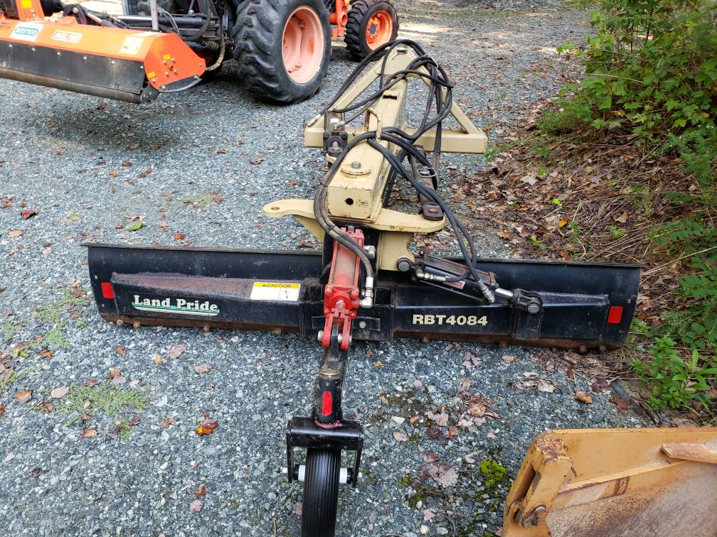

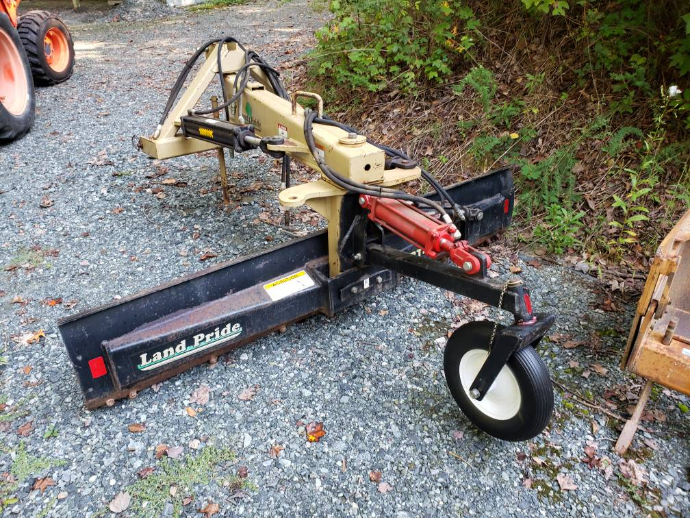

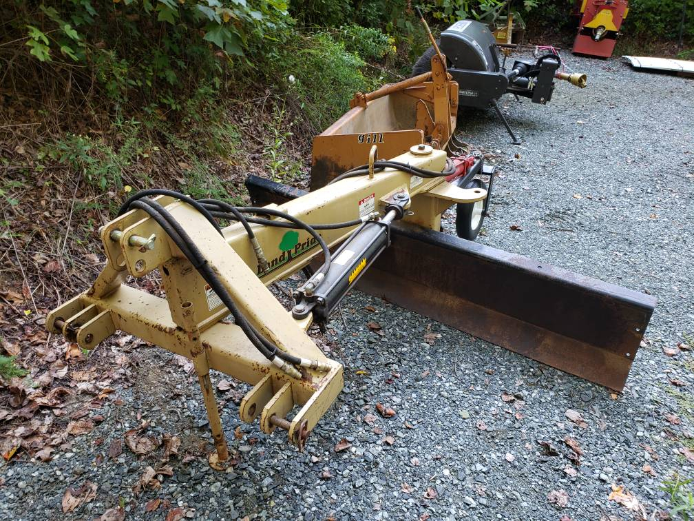

I just picked up a used RBT4084 for L3240 the other day, haven't had a chance to use it yet because I need to change out the couplers for the cylinders.
It looks like the main difference between the 40 and 35 series is just the bracing is a little thicker and the main beam is a little longer on the 40 series (adds about 89lbs on a 84in).
The 40 is overkill for my tractor but it was a decent price which is why I got it. With the extra HP the 96 would be a great size.
With R4 at the narrowest setting I can go to 30° and still cover my tracks, the 96 would allow me to go to 40°.`
They are nice stout blades!
Still want to add one more cylinder and get a better gauge wheel.
