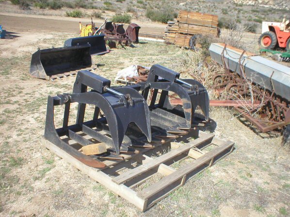

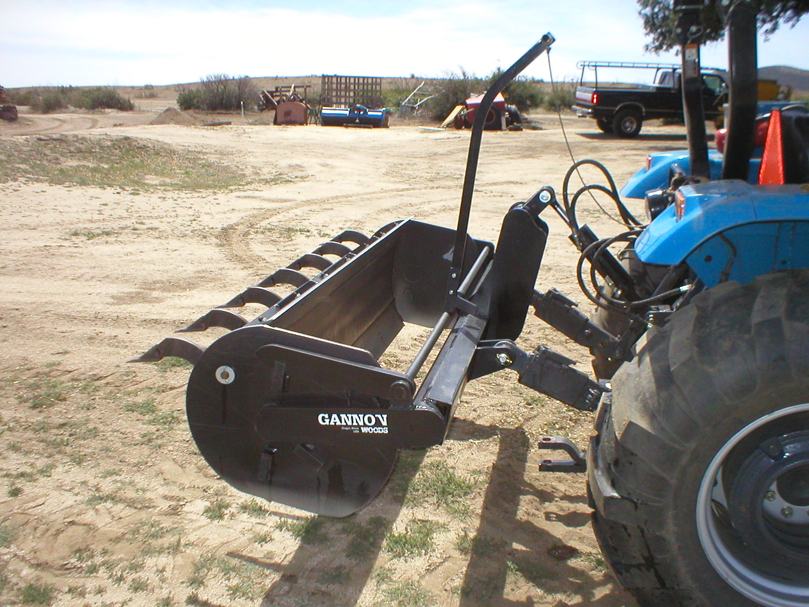

Get the stronger loader and plan on getting a root grapple, so you will need either a diverter valve or a 3rd function valve for the front. The grapple will make dealing with all of your trees a snap. :thumbsup:

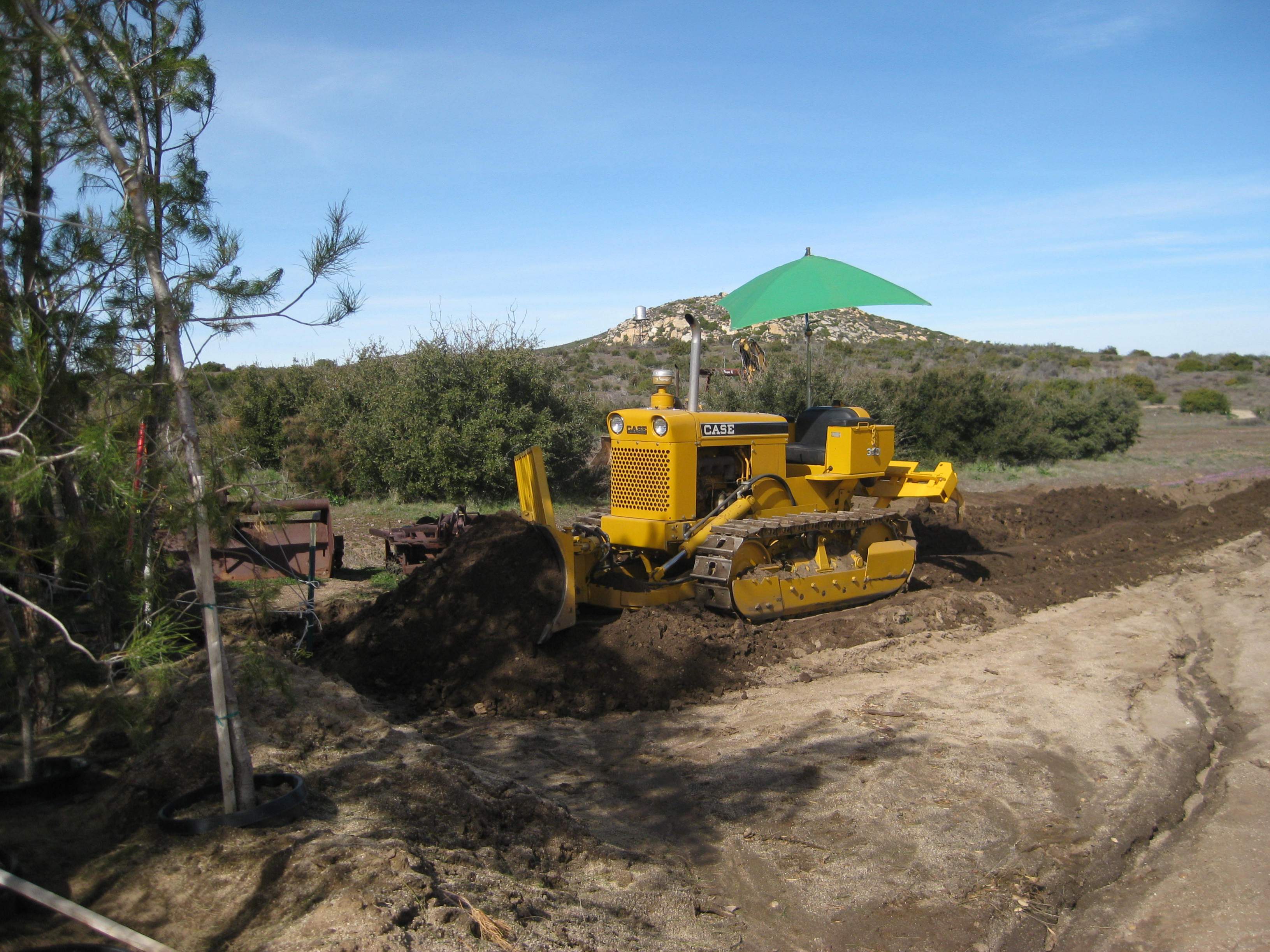

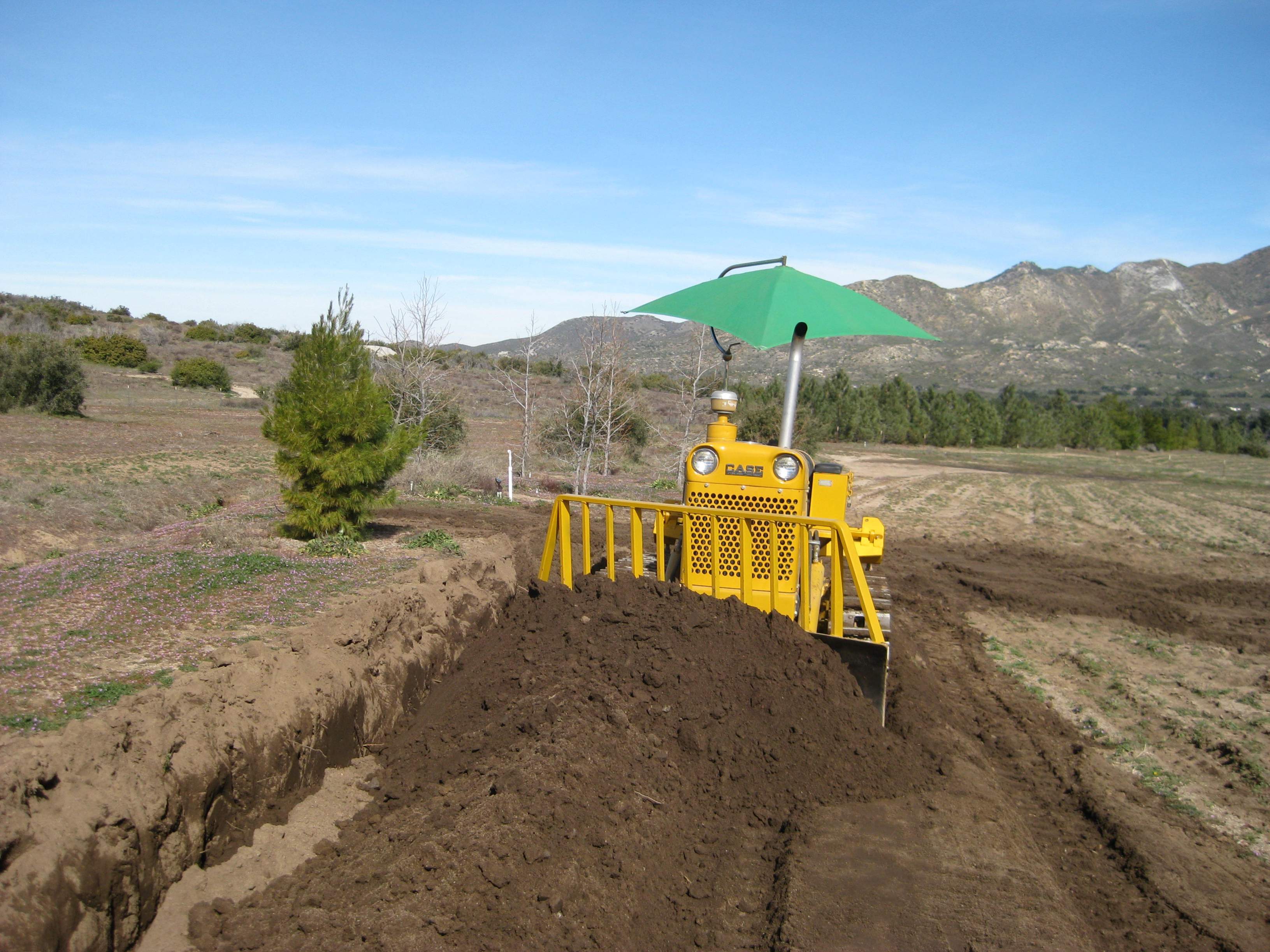

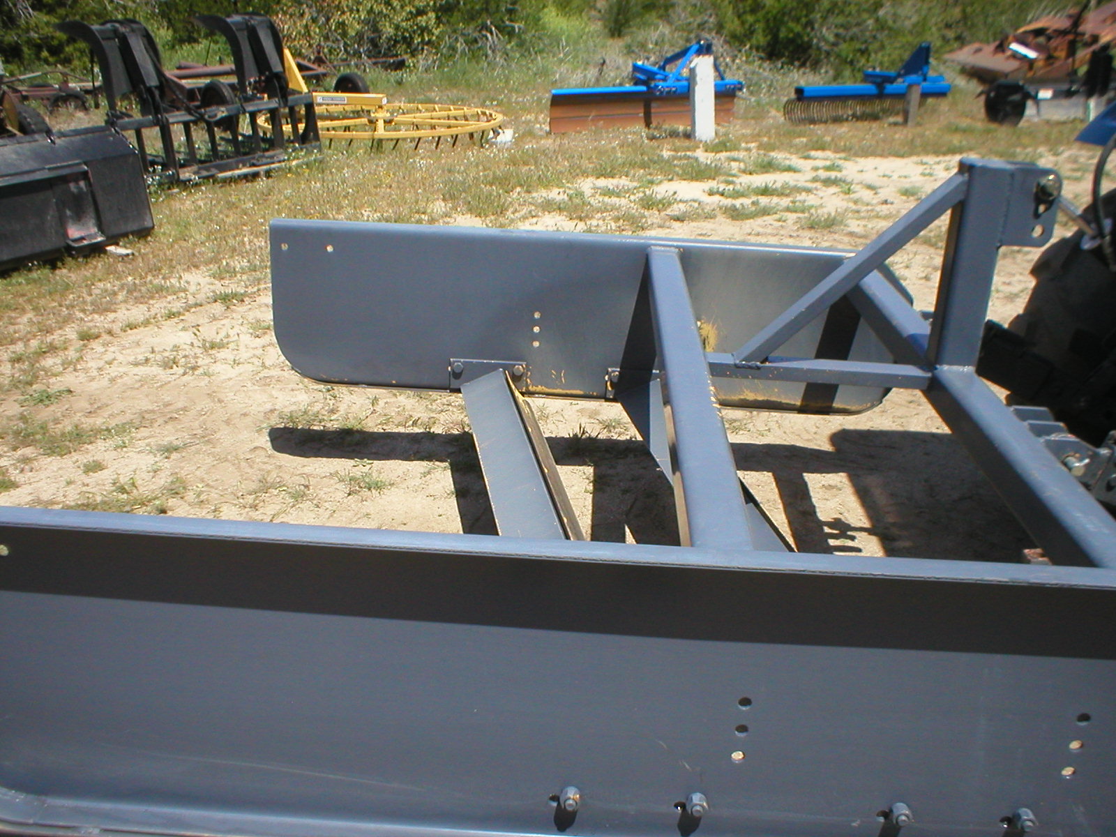

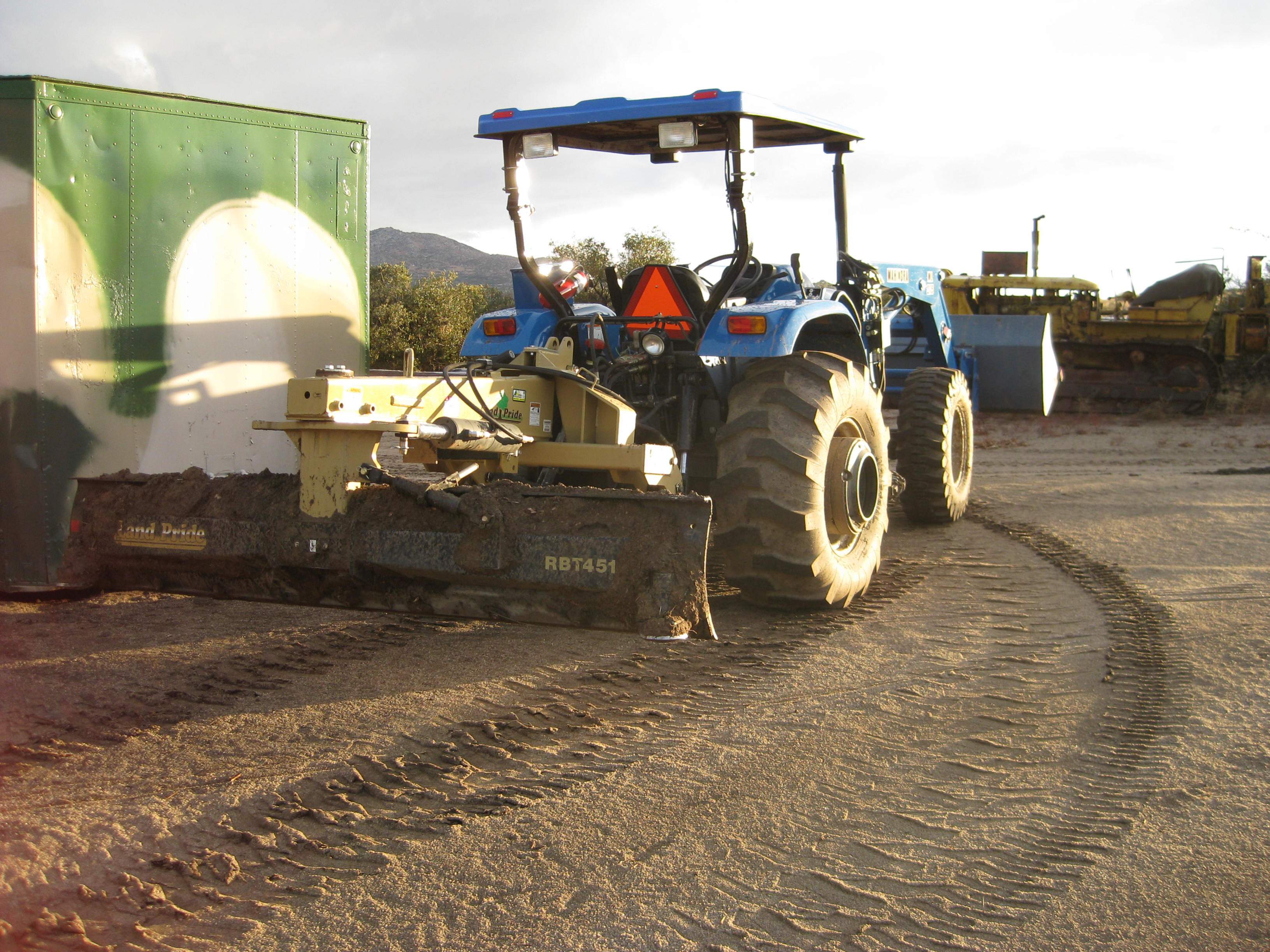

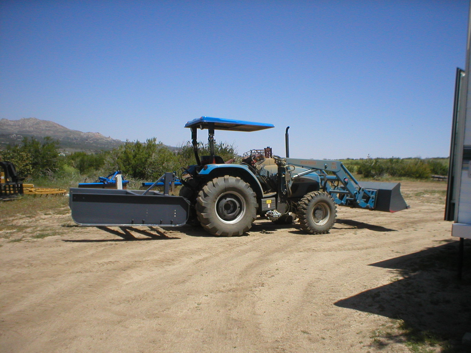

Here are a few pictures to give you an idea. My tractor is a 75hp machine and I too take care of a little over 2 miles of roads.
I have a dozer also, don't really use it very often since I got my utility wheeled tractors.
Good luck with you decisions. ;)

MtnView Ranch, thanks for all the advice and the pics. It look like your Landpride RBT451 rear blade is very similar to the RB2307. I talked to my dealer this morning, and he said he had never sold one of those, so he couldn't tell me much about it. He did tell me that the 2 additional rear remotes would run about $1300, so I am looking at paying about $3400 more to get the heavy blade with all the hydraulics vs the light one that only has an angle hydraulic. I really don't see where I would need a hyd offset control for working firelanes, so I might save close to $1000 by just adding one rear remote.
I don't even know what some of that equipment in your pics is, and I can't see myself accumulating as much as you have. If I move to the farm someday, things might be different, but right now I think I can get by with a FEL and a good rear blade. This farm doesn't produce a lot of income, so I've got to keep it reasonable on how much I spend on equipment. But I think everyone has convinced me that I need to forget the el cheapo rear blade and go with the heavy one. All of these additions may make the trade financially foolish, and I may wind up just keeping what I have. Guess everyone can tell I'm having a hard time deciding what to do. The dealer is coming tomorrow to look at my equipment and make me an offer. I'll let all know how it goes.
