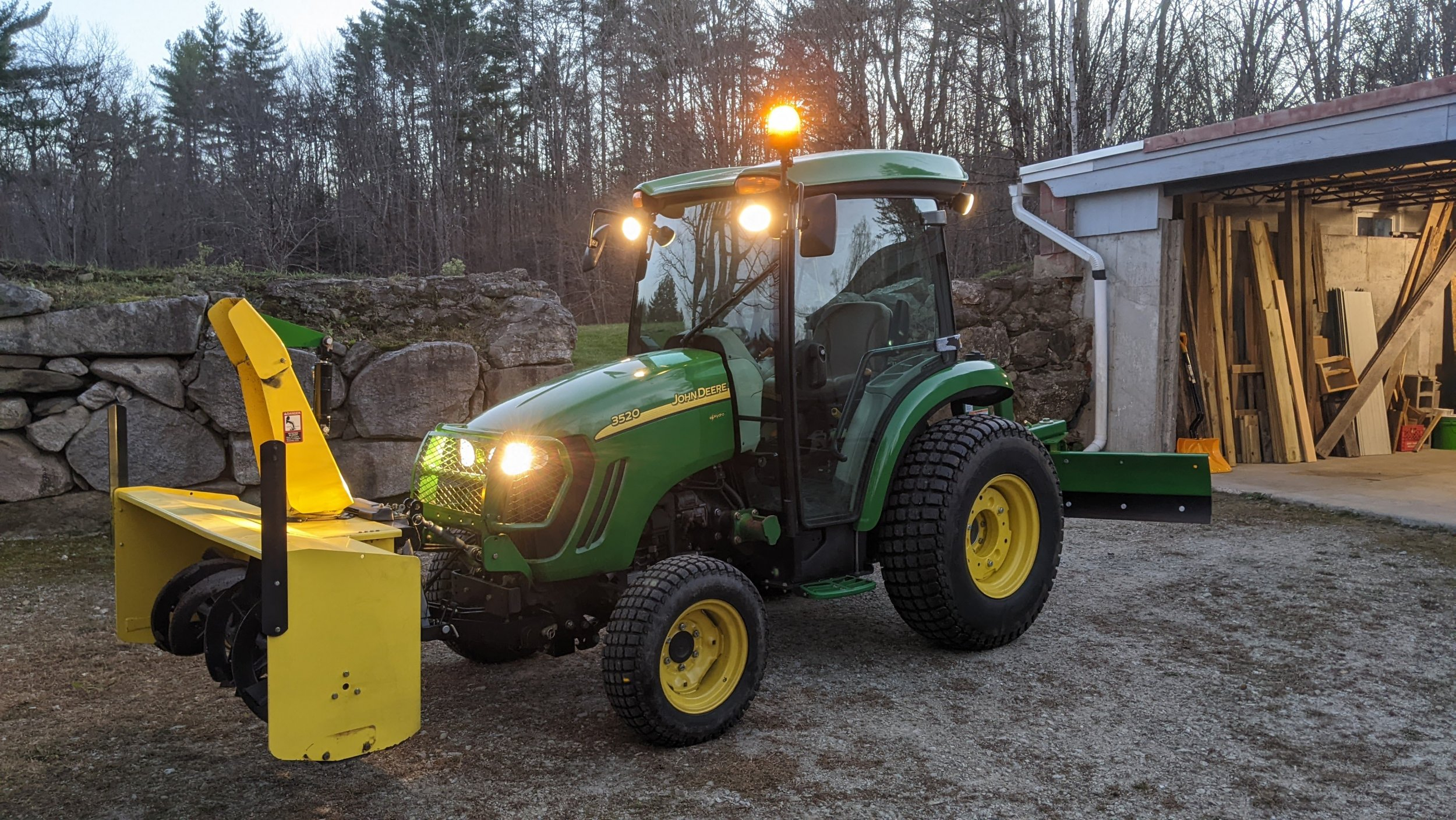

Nice setup you have. I think a little bit of "chatter" is routine when plowing small amounts of snow. You could slow down. My previous plowing tractor had a lot of down pressure but if I went all in with down pressure I was really roughing up the asphalt as the blade wanted to dig hard. Out of the question on gravel parts. I got less chatter lightening up on the draft.

Not familiar with i-match.....but general quick hitches have alot of slop. If there is any slop in the i-match....shims/washers/bushings. Tighten it up because that adds to chatter
Winner, winner, chicken dinner! I think this is the real culprit. If you go back and re-read my original post, I said specifically that picking up the hitch just enough to take the slack out cured the problem perfectly.
I will investigate if angling the blade more forward (I'm not going to reverse it) helps lessen the problem, but I'm betting the slop in the iMatch is the primary contributor to this problem.
