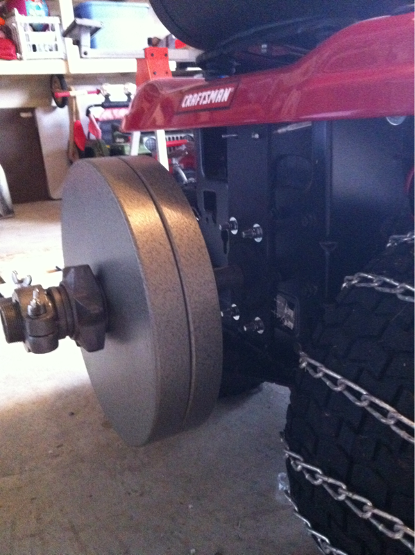

I built a bracket for rear weights but can't find a weight limit anywhere for the rear axle...
I don't want to learn the hard way that I put too much weight on the back!

I'm looking to put at least 70lbs on the rear. I have a 30lb wheel weight in each rear tire. I weigh 215lbs... I can always liquid fill the rear tires but that sounds like a pain...
   / Rear axle weight limit? #4
I think the liquid in the tires applies the least amount of load on the transaxle.
Nothing to putting windshield washer fluid in the rear tires. Just lay them down, break a bead and pour it in.
I'd be worried less about the weight on the axles than I would gaining so much traction that the transaxle wouldn't take it. Might be better to get some slippage when under a pushing load.

I decided to go ahead and put the fluid in the rear tires. It took almost exactly 5 gallons in each tire! I was surprised it held so much. It is only a lawn tractor with relatively small tires...
That give me roughly 100 pounds in the rear without straining the axle! Couple that with the 60 pounds of wheel weights and I may not need any other weight in the rear. It just started snowing so we will see...

I ended up putting about 80lbs on the rear weight bracket I made to hold Olympic weights as well. A test run showed it was a little hard to steer. I over inflated the front tires slightly and added the extra weight and it helped a lot! I'm not concerned about stressing the axle with 80lbs. I'm sure it can handle that...
