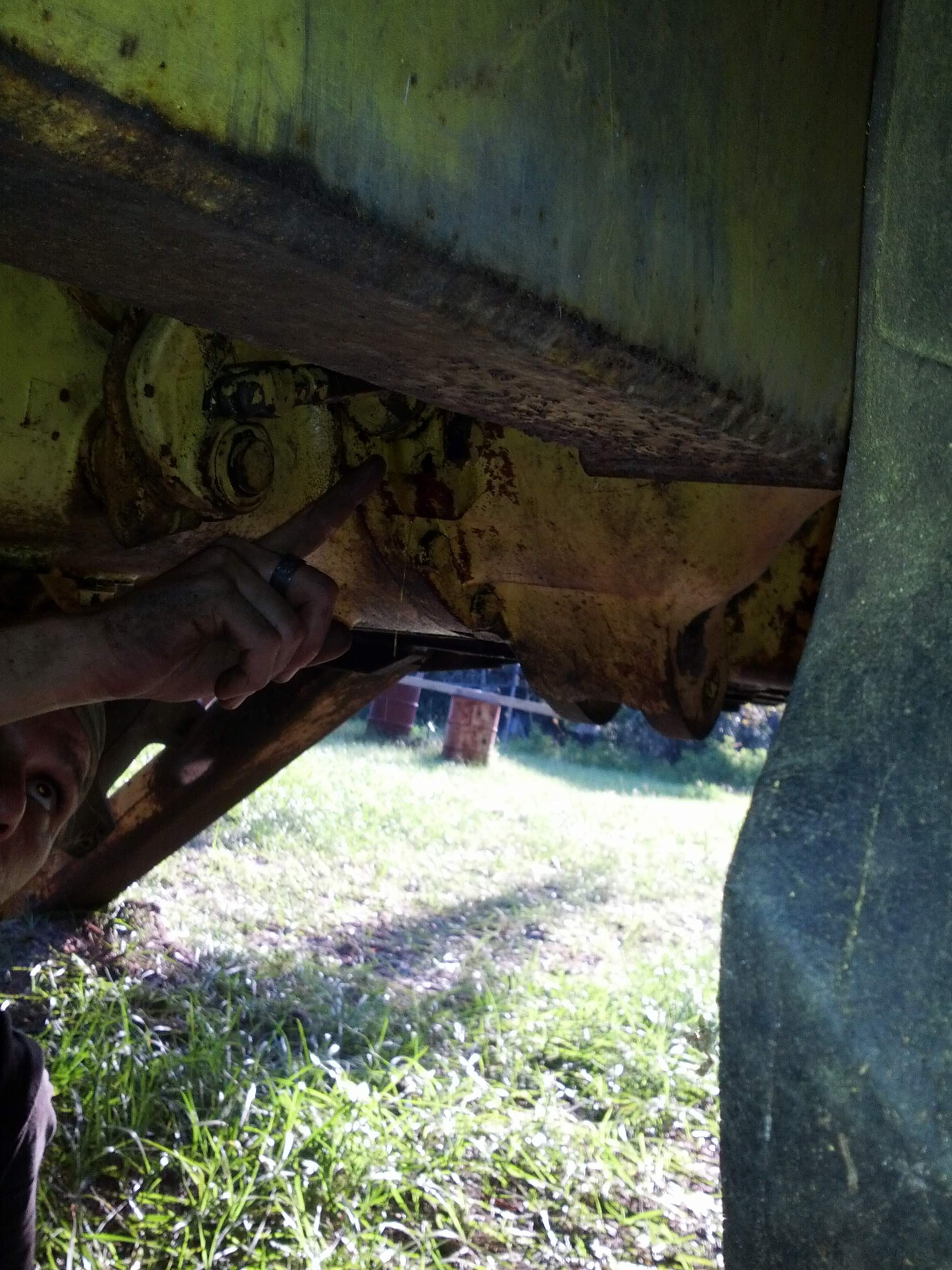

Just change the rear axle fluid and found my rear brake is leaking a lot if fluid. Anyone familiar with this issue? I cant say as Ive ever seen brakes like this in my life. Maybe I should stick to motorcycles. There is a bolt that threads into a hole on the rear axle (on both sides of the gear housing) and fluid is draining out at about a quart a minute. Not sure if screwing it all the way in will help or exasterbate the issue and Id like to avoid doing donuts if I hit the brakes. Im attaching a pic thats not the greatest but Im pointing at the area.Ling bolt on one end with what looks like a welded washer on the other end. GOD I hope nothing broke (bolt) because my Boss wants his backhoe by Friday and I dont think I can rebuild an entire rear end in 3 days. HELP!!!

I tried Messicks for a part by part list and diagrams. Seems they omitted some items from the list and photos. The part I tried to discribe was the "pull rod nut". it seems to be leaking from the housing that the bolt screws into.

No joy with diagrams. :( I really didnt want to open that beast up but it looks like the only way. Exploratory surgery seems ineveitable.

Got this problem fixed. Seems the metal ring came off the rubber seal. Cold chissel and a lot of cussin' got it out. :cool2:
