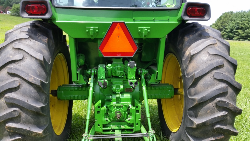

I have a LS G3033H and see that I can mount a 7-ploe connector on the rear aspect of the tractor. I have a small 15-gallon sprayer that I want to connect to a 3 point carry all and wanted to see what specific type of connectors anyone is using on the rear end of their G3033. The connector that is one the sprayer is a 2 wire male - female plug, so I do not mind changing it over to something more useful. I could see connecting a small winch to the rear aspect, so a larger style plug would be feasible.

This would go onto the tractor (Pollak Heavy-Duty, 7-Pole, Round Pin Trailer Wiring Socket - Vehicle End Pollak Wiring PK11720), do not know what the back of you tractor looks like, you could make a bracket and mount it on the back of your tractor. The wiring on the back of my tractor for this is.

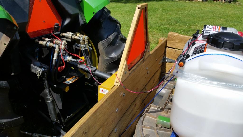

I just completed what you are thinking about doing.
Nothing fancy, but it did the job. I have attached a picture of the sprayer mounted on my carryall and wired into the tractor. I also attached a picture of the wiring for it, basically I plug it into the sprayer, into the tractor and I have a switch that I can operate from the seat.

You could use this (Pollak Heavy-Duty, 7-Pole, Round Pin, Trailer Wiring Connector - Trailer End Pollak Wiring PK11700) to connect to your sprayer using terminal 1 and 4.
The Pollak connector came on my tractor. I would go with the round connector and not the RV type as most tractor attachments I have seen use the round connector.

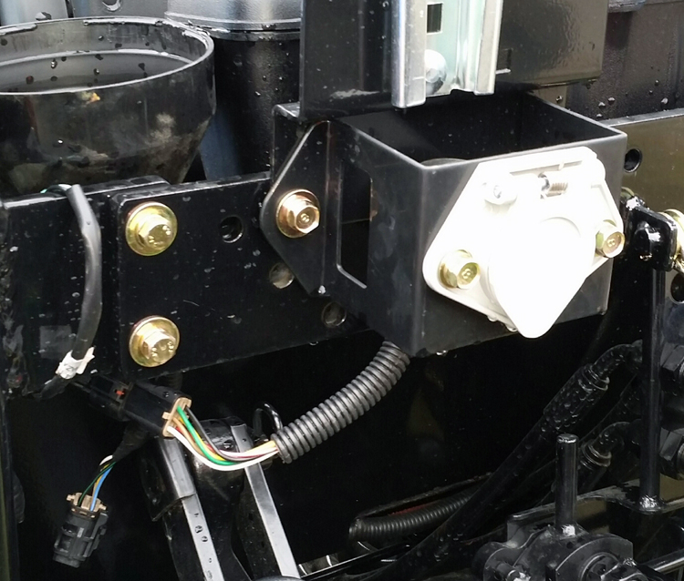

My neighbors dad had me install the connector on the back of his 4230, just turn signals and lights. It was a kit from John Deere picture attached. The kit used 16 gauge wire and the ground was just to the strap that the connector was mounted too. I had some of that plastic tubing that I got from Lowes and put the wires in that for protection.

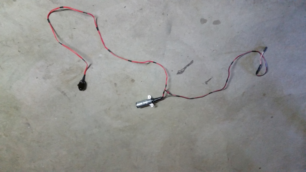

My DX55 came with the 7 pole connector, and I too wanted to come up with an adaptor for my sprayer. I made an adaptor plug using a 7 pole plug, and a short 2 pole pigtail plug. Now I can plug that converter into my 7 pole tractor outlet, and have a dangling 2 pole plug to use when needed.
Then I made a new extension cord with a switch, with 2 pole connectors. It is actually very similar to JD5210's homemade version, but I used a 2 pole plug where he used the 7 pole (since I already made my converter plug for the tractor). Also, I made mine longer so I could put my sprayer on the carryall, pull it on a small trailer behind my tractor, OR my lawn mower. That's where the 2 pole plug comes in handy on the extension cord. I used this wire for my extension cord, since it is good flexible wire with high quality insulation and 12 ga wire so I won't have to worry about voltage drop over the longer distance. http://www.menards.com/main/p-2752371-c-6410.htm
It works great! The soft flexible cord is so much easier to manage than the stiff OEM wire on the sprayers and cords.
