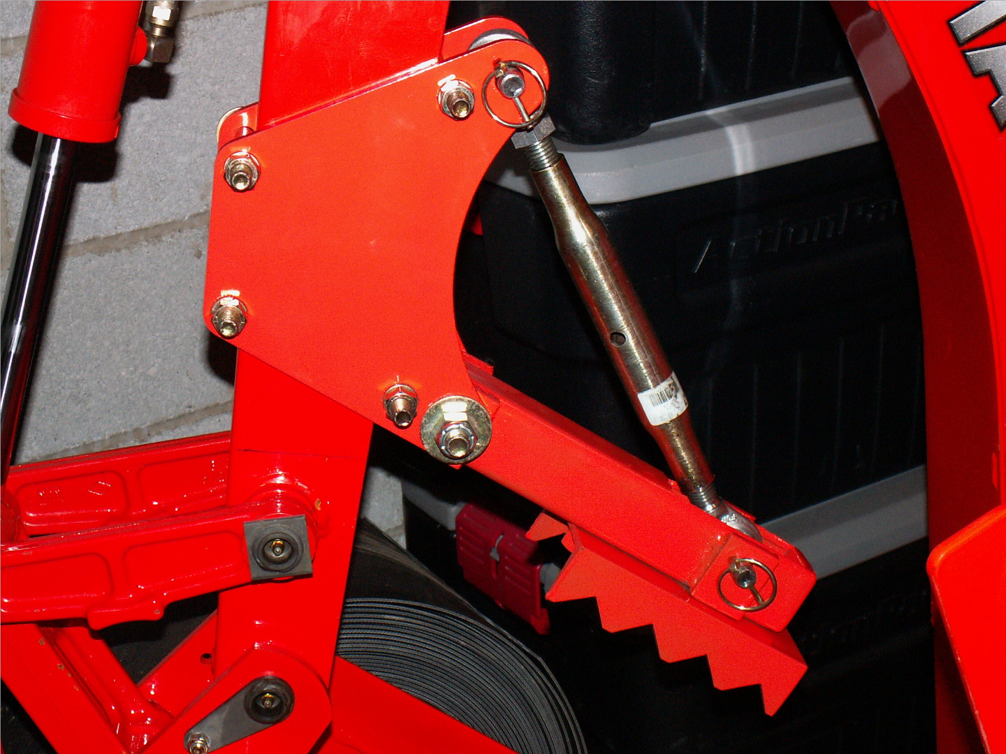

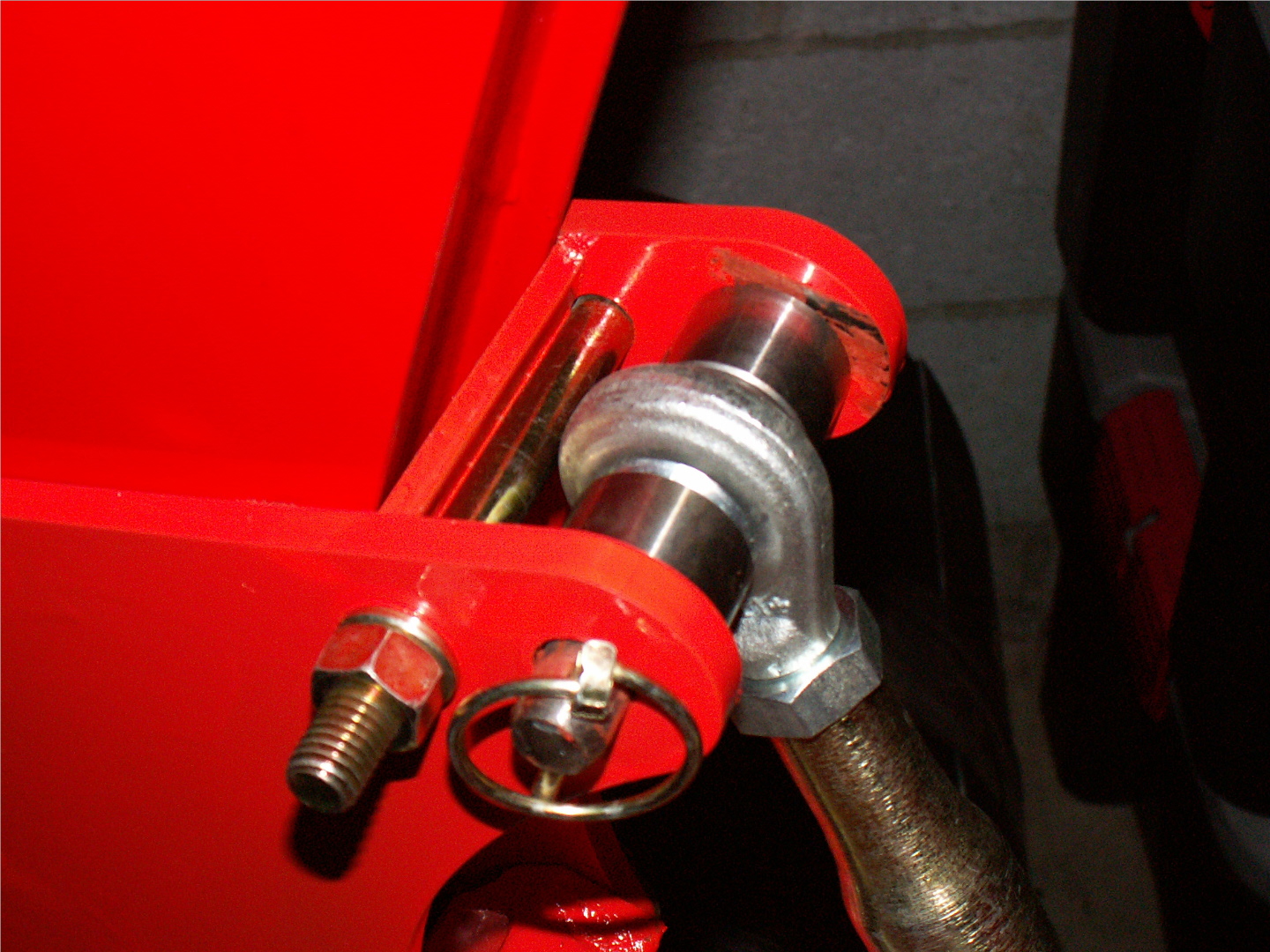

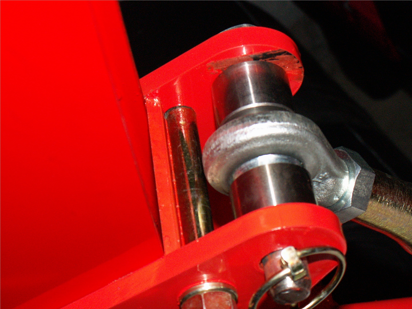

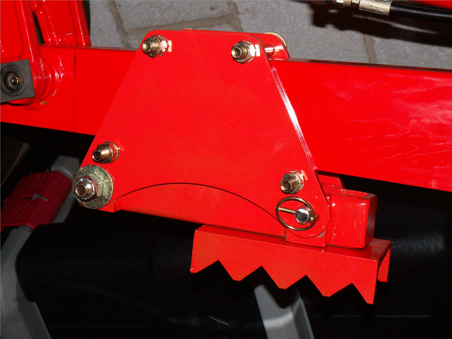

Go with the Bro-Tek its a much better design. I made one somewhat similar to the Bro-Tek but modified it to utilize the taper of the dipper stick so it wouldn't move or slide up when using it. It has worked out well and its like a Timex, takes a licking and keeps on ticking!
On another note, do yourself a favor and NEVER weld anything to the dipper, that could be a very costly mistake once the welds start cracking. The material is just to thin on the dipper to really weld to it properly in my opinion.
Attached is a pic of the one I made, of course with some design changes compared to the Bro-Tek. The trick is the position and location of the bolts and the installation of the thrust plate between the bolts and the dipper. The pics show it all.....
Good luck!
Craig

I agree it's not great to weld to dipper stick, it's very thin.
The wallenstein is designed to utilize the taper as well. But due to it's ability to grip things close to dipper stick it's enough to start crushing the dipper stick as it wedges against the taper.
