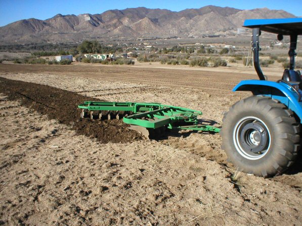

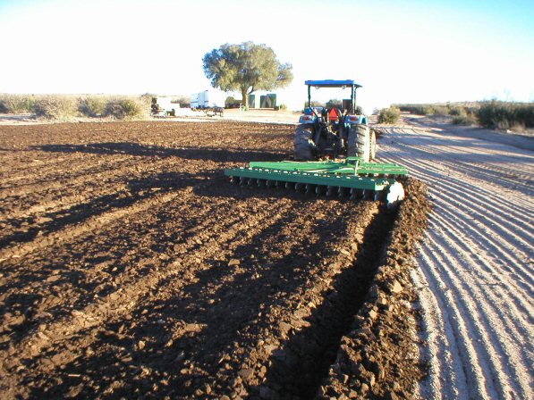

A lot will depend on what type of ground and terrain that you have. An offset is generally considered to dig a bit more aggressively, and I do not think that you are supposed to turn to the right very sharp. It puts a lot of strain on the unit as a whole. :eek: Some of the old drag disks were set up so that right turns could be made,:cool: but I think that any new wheeled transport disk is going to be a left turn only type of disk. :(
We have 22" notched disk blades on our old Kelfer (John Deere) offset drag disks, and they seam to work pretty good. I pull an 8 footer (about 2500 lbs) with my Mahindra. I have pulled our 12 footer ( about 4000lbs) before, but only on pretty much flat ground, and it will not pull it through a second time at a 30 degree angle, which makes the ground very nice. Our old D6 pulls the 12 footer most of the time. When pulling our disks, the blades are usually cutting 8-9 inches deep.:D That is a lot of drag being put on the machines and the disk units themselves. Here are a few pics of our setup.
