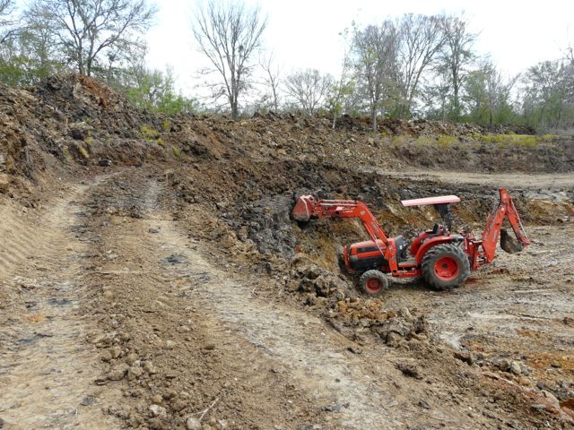

I have a 4WD 50 hp Kubota and I have pushed over cedars that size with no problem. I also have a spring pond but I could not clean out the muck because the water would come in faster. I had to hire a large track hoe. I posted about it here http://www.tractorbynet.com/forums/rural-living/216321-opening-up-spring-track-hoe.html on TBN.
I did clean out another pond that dried up last summer. It took about a week. The mud had been up to where the FEL is at in the picture. I just used the FEL not the BH.

As for digging. Some soils dig ok where I am in Bismarck Arkansas with very few rocks when a few feet away might require removal of large boulders. Photos of pond I did in two days with my 7010 without a tooth bar. Tooth bars help tremendously with rocky soil and even sandy clay.
